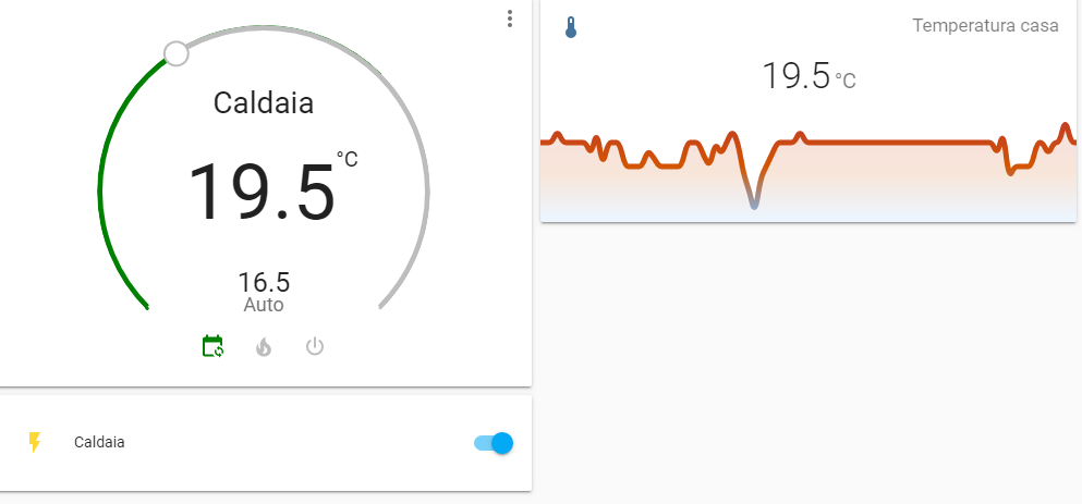

Good to know that the Beok 313 is working ok. Next week probably I will install mine. I hope that I can manage to make the integration with HA
Fixed and seems to work, i set the entity in the graphic frontend. I can’t understand how to use the internal schedule of the beok, any suggestion?I just want it to continue using his internal schedule and turn it on manually when i want it
