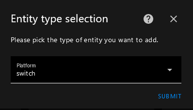

I’ve gotten to this part, Home Assistant found it within the localtuya integration. Not sure which to pick here though?
I guess ‘climate’ but that’s all about a thermostat. Did you add a custom platform?
I’ve added all the field as separate entities. (This is true even for a fan that has it’s own entity type – the dedicated entity type didn’t work well.) You can look at the table above. The types aren’t explicitly mentioned (and I don’t remember them by heart), but they should be more or less obvious from the description.
So, as first, you can pick switch type, select id=1 (assuming you have the same numbering – I am afraid there isn’t easier way than to try it) and add entity for switch. When you finish adding the entity, you will be asked if you want to add another one. It isn’t much user friendly, but it’s doable.
