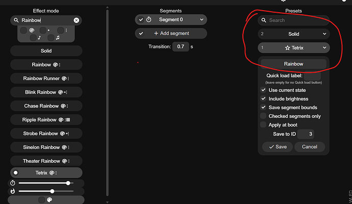

Just add the effects you want into presets then they show up in HA
