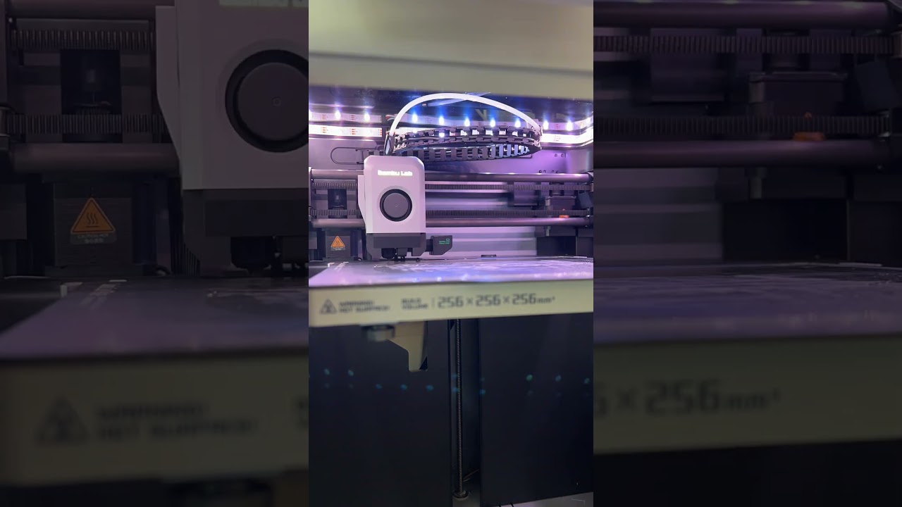

Support for adding LED chamber lights via the WLED.
Requires the WLED Home Assistant Integration and the requiste LED lights and ESP device.
Clink the link below to import the WLED blueprint
WLED Features
LED lights automatically turn off when Bambu Lida is in use so as to not interfere
LED lights turn red when there is an error in the printer
LED lights turn blue when bed is auto leveling
LED lights turn green when print is finished
