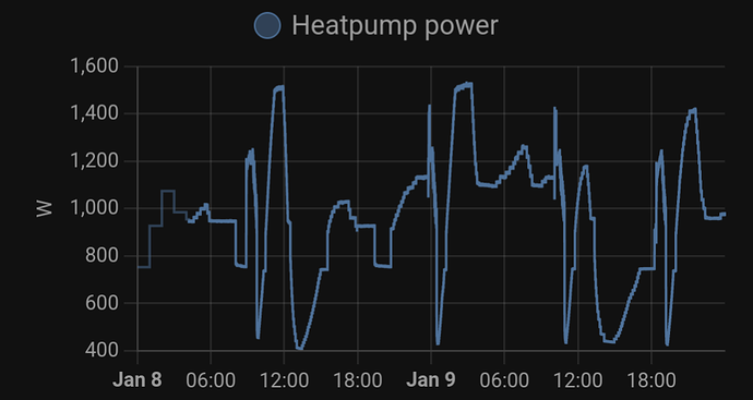

Next up, I looked at the power consumption. This was my starting point:
Normally, I’d recommend to be careful with changing a pre-determined heat curve, but this was a good time to make small adjustments.
This video explains how to adjust the heat curve and what the values mean: https://youtu.be/7WS2MhA43ns?si=2xcZUog8OsPuvX1h
I lowered “heat curve 1” 0.5C every other day until the room temperature matched to the target temperature.
I also lowered the room thermostat impact from 200% to 150%
This where I am now. The narrow peeks are hot water which can be ignored. There are still some odd spikes and dips which I hope to get rid of, but it already a lot more consistent and comfortable.

Looks like hysteresis is not set correctly i.e. too low. My heating output curve is very flat. 2-3x a day.
