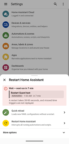

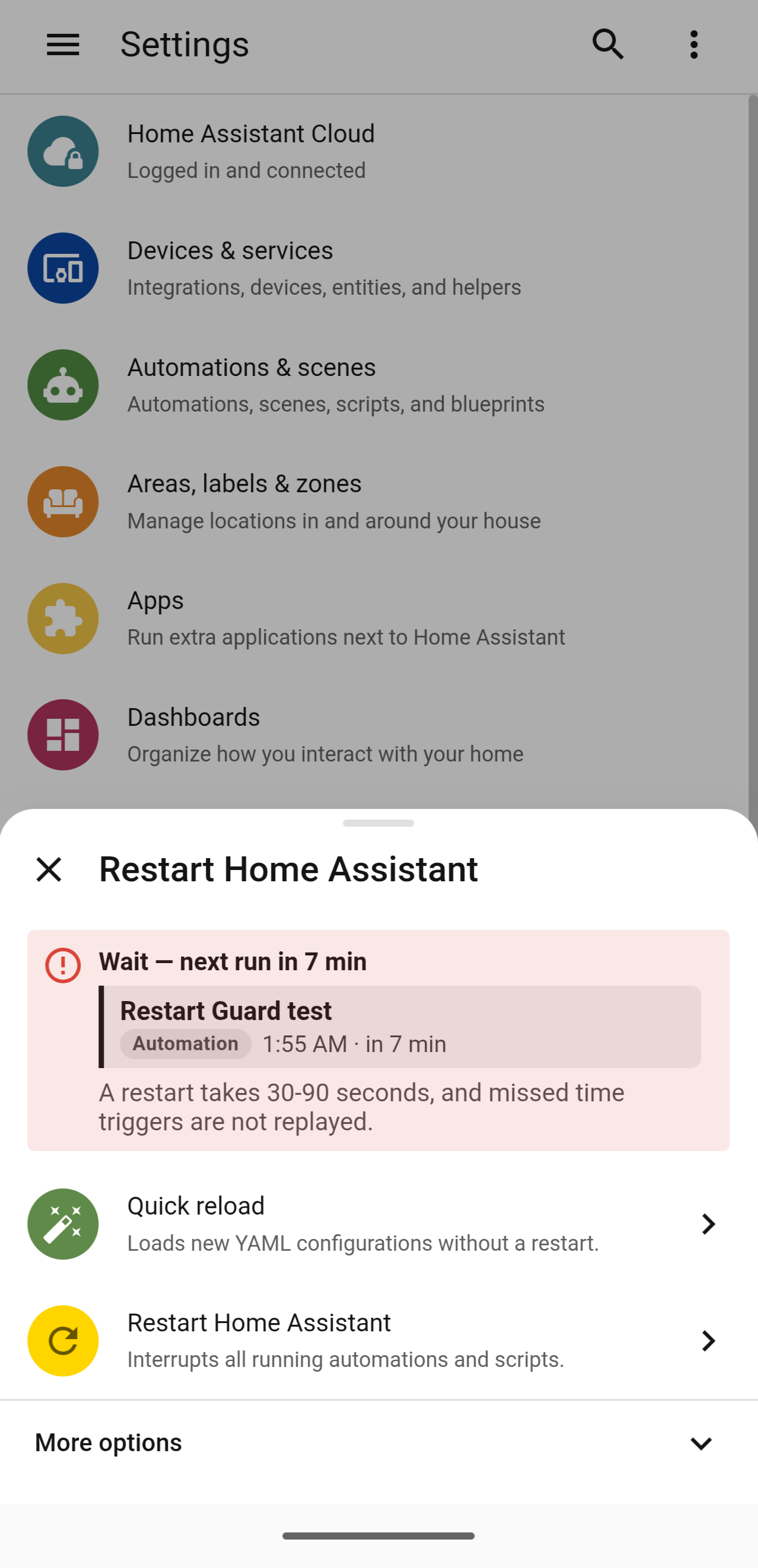

I made this. It will help you a lot.
Basically, it gives you a popup when you’re about to restart Home Assistant and you have an automation that’s currently running or about to run.
It works with:
  • Automations
  • Scripts
  • HACS update restarts
  • Home Assistant Core update restarts
  • Scheduler, if you use it
GitHub:
See image on how it looks
Enjoy!
