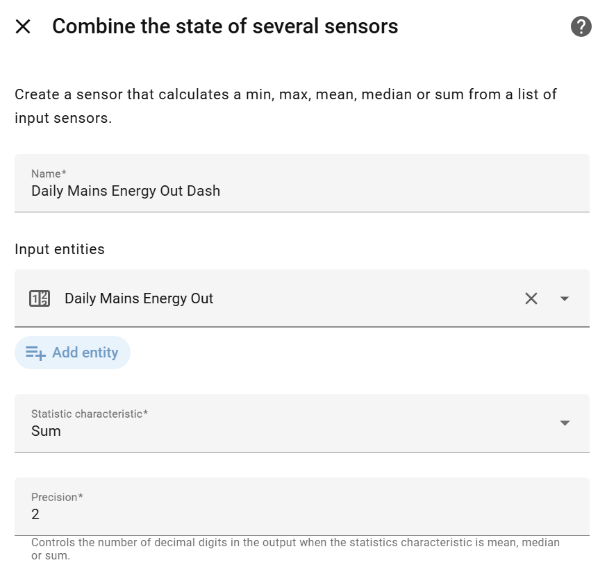

For each entity to be used in the energy dashboard
  • create a helper entity of type “Combine the state of several sensors”
  • use “Sum” for the statistics characteristic
Shouldn’t that create a layer of abstraction?
So, whenever a sensor changes, you just add or remove sensors from the helper and the LTS entity ID should not change at all.
That will work but most people won’t like that as a solution for some reason.
It only works if you do it right from the start. But typically people set the dashboard up using the original sensors. Then you find out it is a problem later on. Then you want to use the sum sensor, but you cannot. If you replace the original entity with the sum, you still loose history. If you add the sum and keep the old sensor, you have double data. And someone thought it was a good idea to change rename behavior, so that is also no longer an option. Plus, if you need to do it for all the individual sensors, it is a real pain. That is where I found out the rename issue was a thing.

If one uses a “Utility Meter” to get daily values, e.g. for Mains in and out, this Utility Meter is already a layer of abstraction.
Just for Sensors which natively give Daily values, as in my case “AC daily energy” from the inverter I have to add the layer to be prepared for the future.
Would it be possible/OK to also use a “Utility Meter” in front of “AC daily energy” or would this give some issue, due to “two times daily” ?
