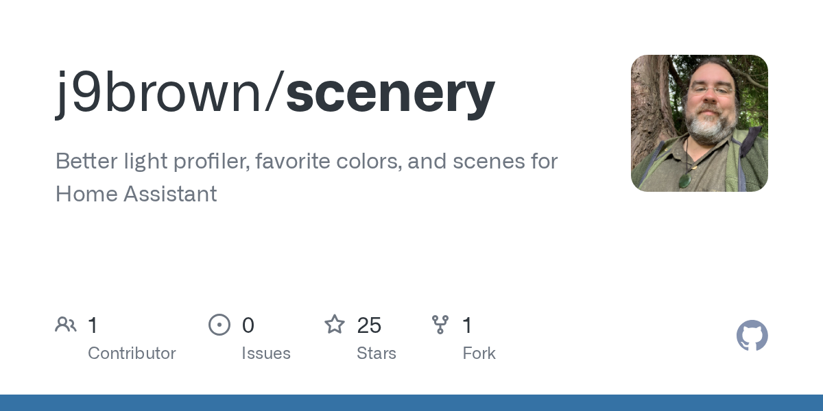

I made a custom integration for this. It lets you define custom light presets and favorite colors globally and represents groups of related scenes as a select entities. Perhaps you’ll find it useful too. :blush:

The scene and scene_select feature of my integration works with any type of entity, not just lights. It just compares attributes. GitHub - j9brown/scenery: Better light profiles, favorite colors, and scenes for Home Assistant
I don’t know whether Scenery would be the ideal way to represent scanner presets in particular but I think it might work.
