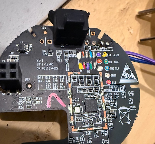

Can anyone help me figure out which pins connect the zigbee chip to the esp32? I tried probing with my multimeter but there isnt continuity between any of the esp32 pins and the test pads on the board near the zigbee chip besides 3.3v, gnd, and gnd1. I did color code the solder pads to the test pins though.
