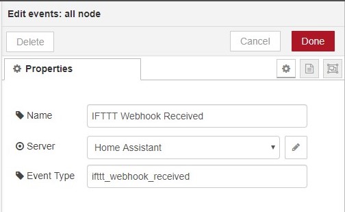

  1. In Node Red, setup the following nodes: ‘events: all’, ‘switch’, and ‘call service’ as shown below. This receives the IFTTT webhook, ensures it’s a motion_sensor or contact_sensor (and allows us to expand off of the webhooks receiver later on), and then updates the associated input_boolean for the device triggered.
NR2
