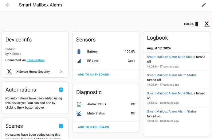

I purchased an SBS50 base station and an SMA51 Mailbox Sensor. The SMA51 is detected right away by the HACS integration. (As shown in the screenshot below.) However, there is not a way to reset the mailbox alarm through Home Assistant as far as I can tell.
For example, after the mailbox is opened the first time, it changes “Alarm Status” and “Mute Status” to “On” in Home Assistant. If you don’t push the button to reset the alarm on the SBS50 base station, then second, third, etc alarms from the Mailbox Sensor will not be caught by Home Assistant since the “Alarm Status” is still “On.”
Will the API let you send every alarm event to Home Assistant, even if the alarm is already triggered? I hope this makes sense. If not I am happy to clarify. :slight_smile:
I have the same sensor, and I posted about it yesterday in Post #210. For me, the Alarm Status and Mute Status both switch to “On” when the sensor is triggered. Have you had any success since your post?

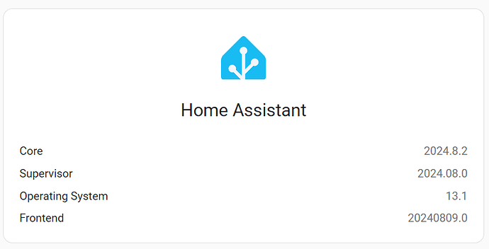

Hello, are there anyknown known problems with X-Sense Integration since the last HA Update 2024.8.2? My Integration is not working any more:
Einrichtung fehlgeschlagen, wird erneut versucht: XSense API Issue: Unable to retrieve house data: 200/{“state”:{},“metadata”:{},“version”:186,“timestamp”:1724106001}

@newslettersns2000 It could be that it is broken in 2024.8.2, but I haven’t tested it yet. I’ll update soon and will try to fix any issues.
It’s working again, since 00:15
