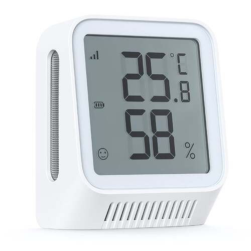

I bought some of the X-Sense smoke detectors last year and integrated them to HA recently. This also worked for some hygro-/thermometers (STH51A) which I use outdoors. For rooms I’d like to use the STH0A devices, as I haven’t found any similar high-quality thermometers with display which have long-lasting batteries:
However, after integrating them to HA I can only see battery level and signal strength - obviously not the most interesting part about a thermometer. I have now seen that they are not on the list of successfully tested devices. Anybody has some idea about this?

I just pushed a small update for @ZukunftPink. STH0A temperature sensors should now work, just like the STH51.

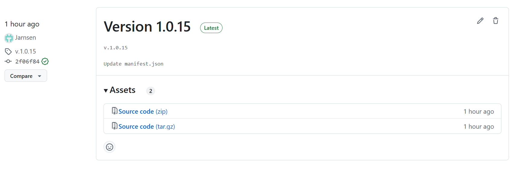

@Jarnsen Can you make a new HACS release?
Great integration, thank you!
