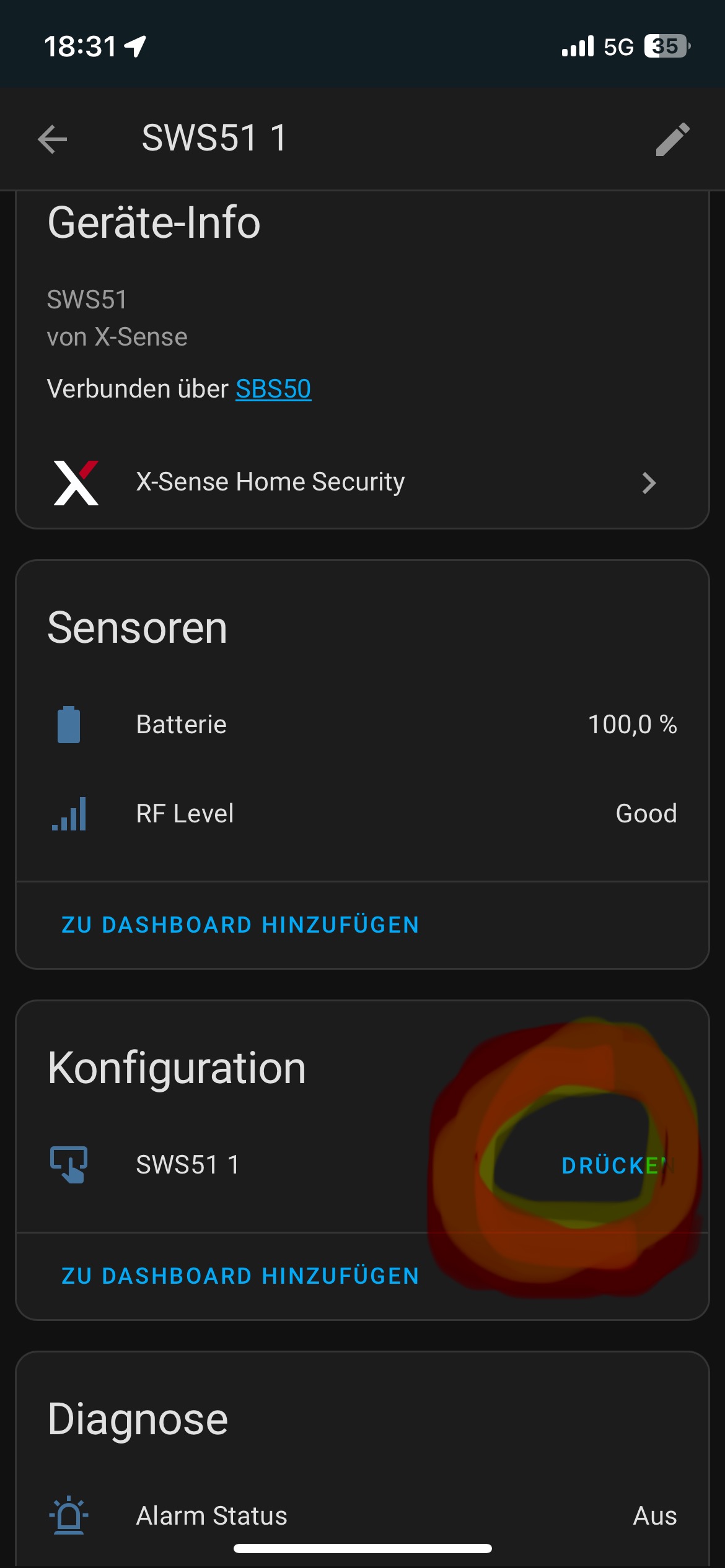

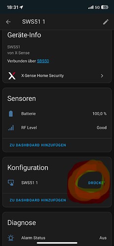

The testalarm is still intecreated

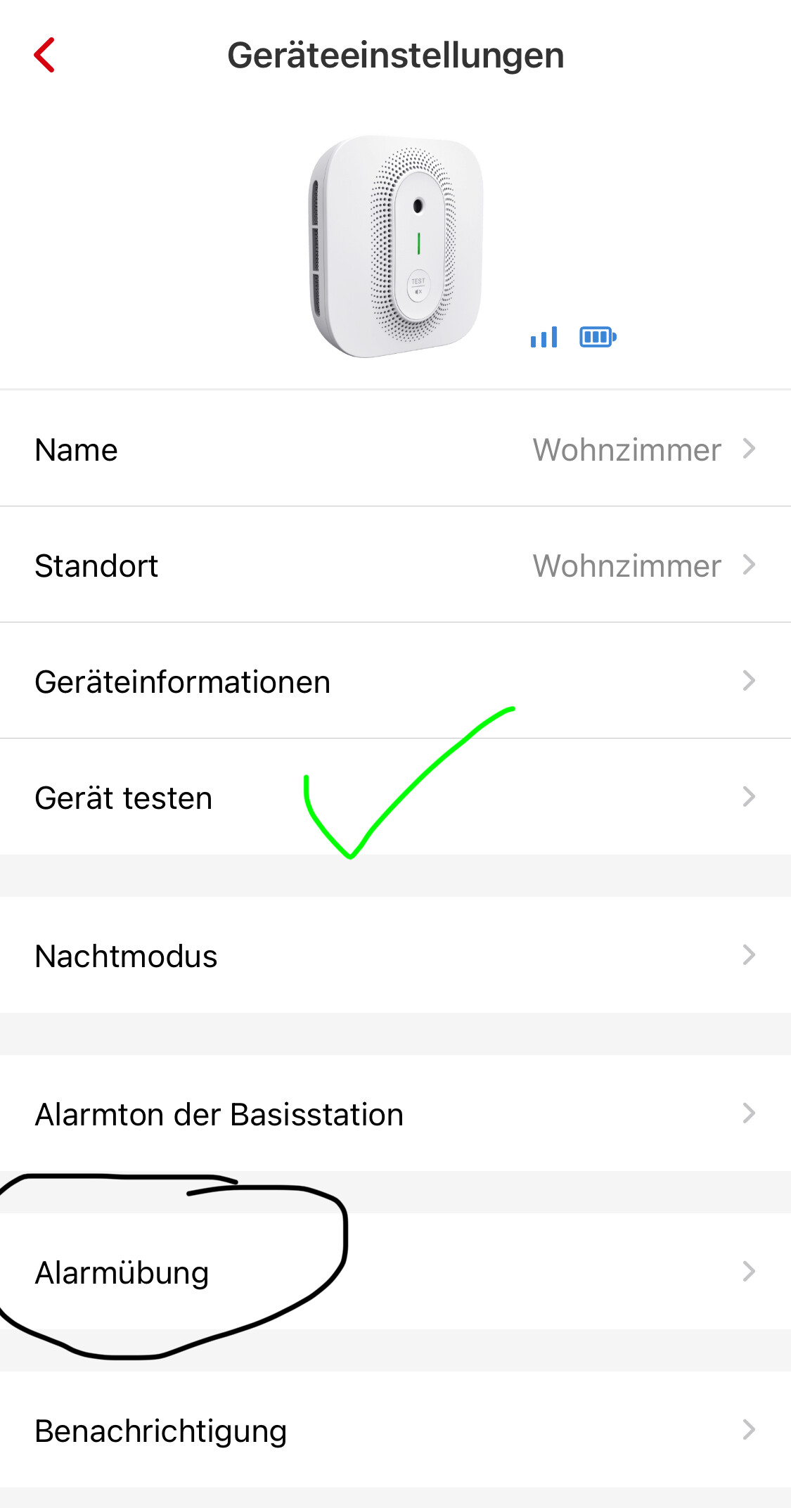

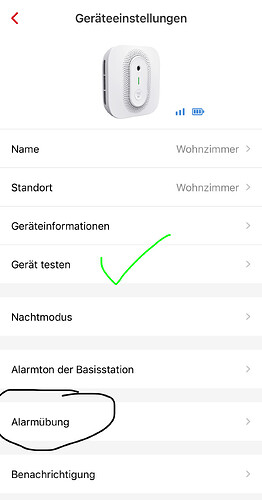

The one I was talking about (marked black) will activate all smoke detectors for 30 seconds. The existing button will do the device test (marked green) which only does the test with three single sounds

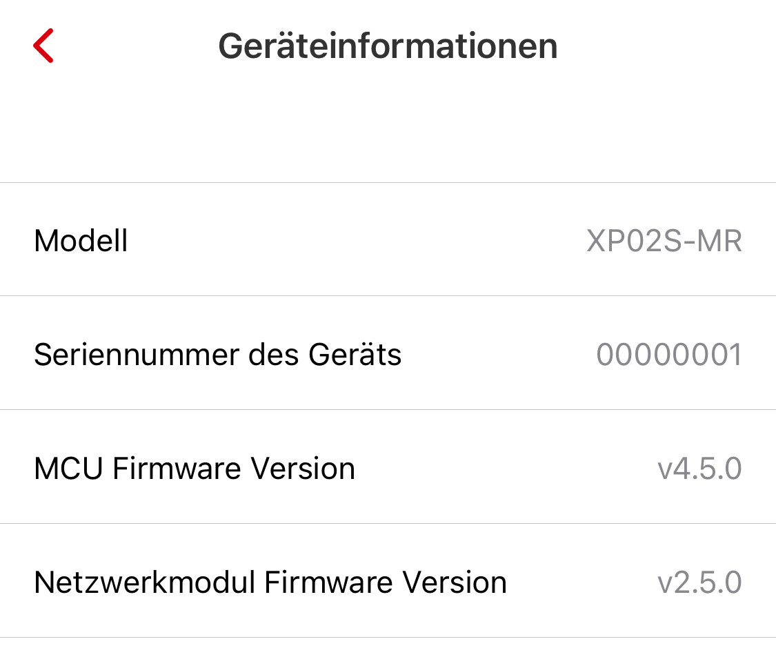

Now it turns out that I don’t have it for my devices. I’ve checked the shared devices that I have access to but that option is not there either. What is the type of your device? I have access to an xp02s-mr, where it doesn’t show up.

I have XP02S-MR devices, I can confirm that the firedrill option is not available to shared accounts - I will ask the question to X-Sense support, maybe there is a good reason why the option is not available for shared accounts (or they just forgot it :smiley: )
