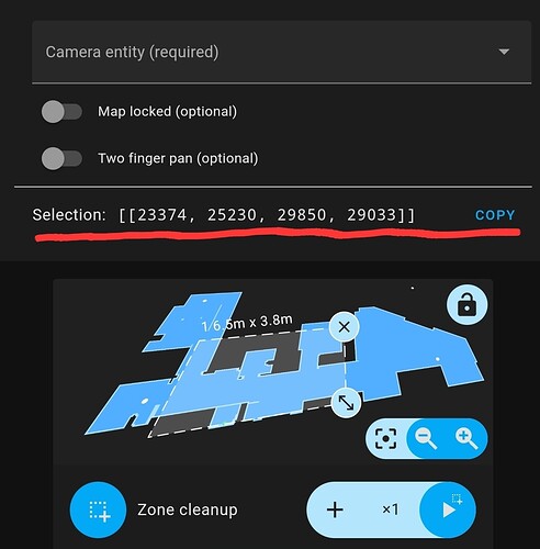

Thanks, this works great! For some scripts i need the coordinates, searched this thread and the internet but is it correct there is still not a really simple way to get the coordinates for zone cleaning?
3_14
(Piotr Machowski)
July 5, 2022, 5:53pm
692
There is a fairy simple one:
But soon there will be an even easier one:

Thanks! Didnt find that with Google…
Also the new option looks very good!
