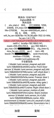

I recently bought this vacuum based on these last two posts, and I can’t get it appear in HA. It’s always Unavailable.
I’ve tried the token as lowercase as well as uppercase.
I’m on the latest version of HA Core.

The token should be correct:

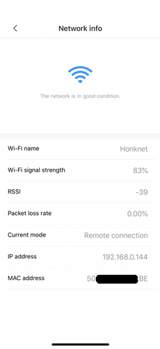

And the IP address of my vacuum (from my vacuum Network settings screen):

Yes, I did. It turned out the instructions (or my brain) are slightly vague, and I was using the wrong token. shuker set me straight.
how did you get your token?
I used the iOS section of the instructions, instead of the first section (Xiaomi Home App) which is what I was previously doing.
