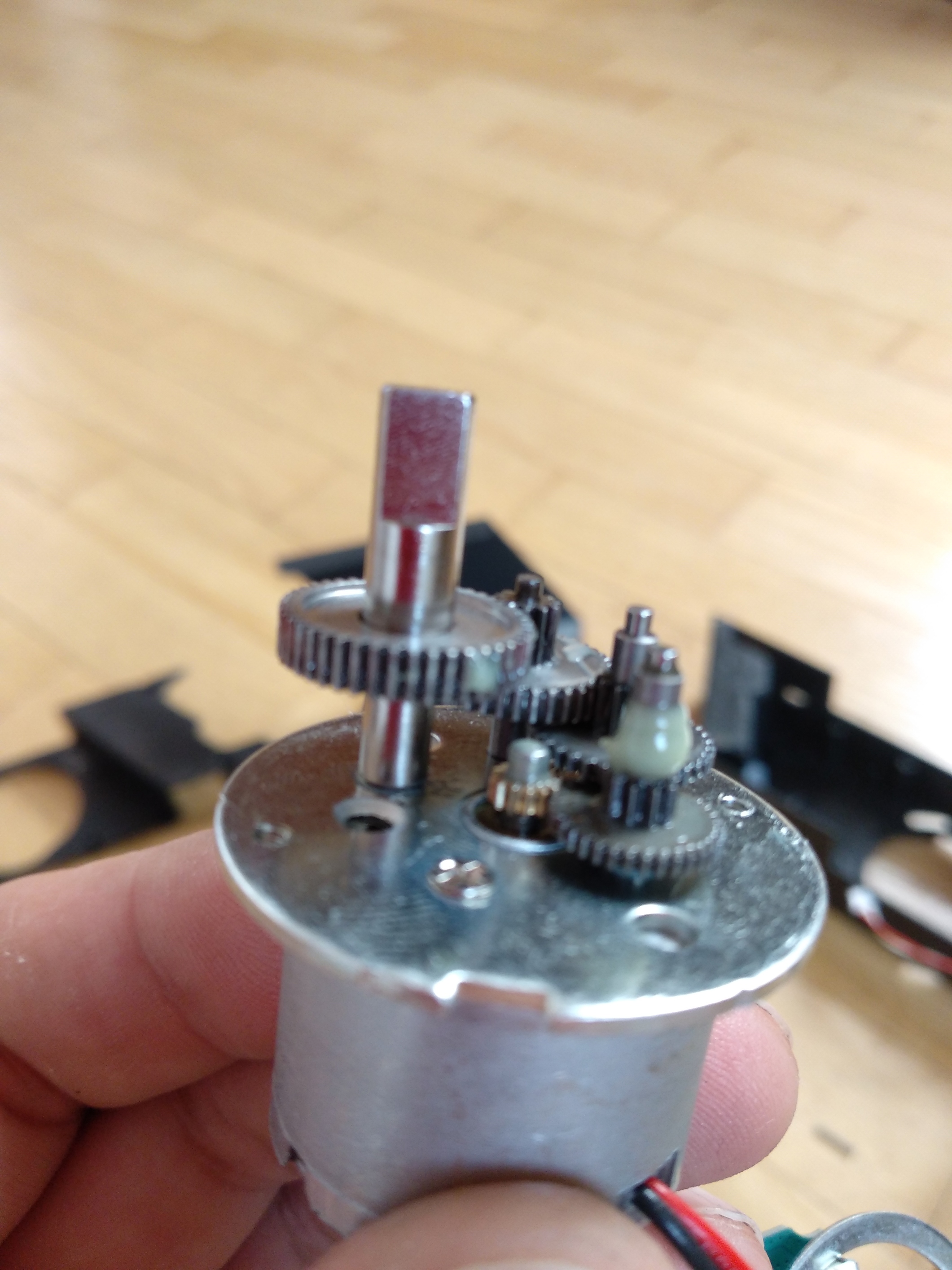

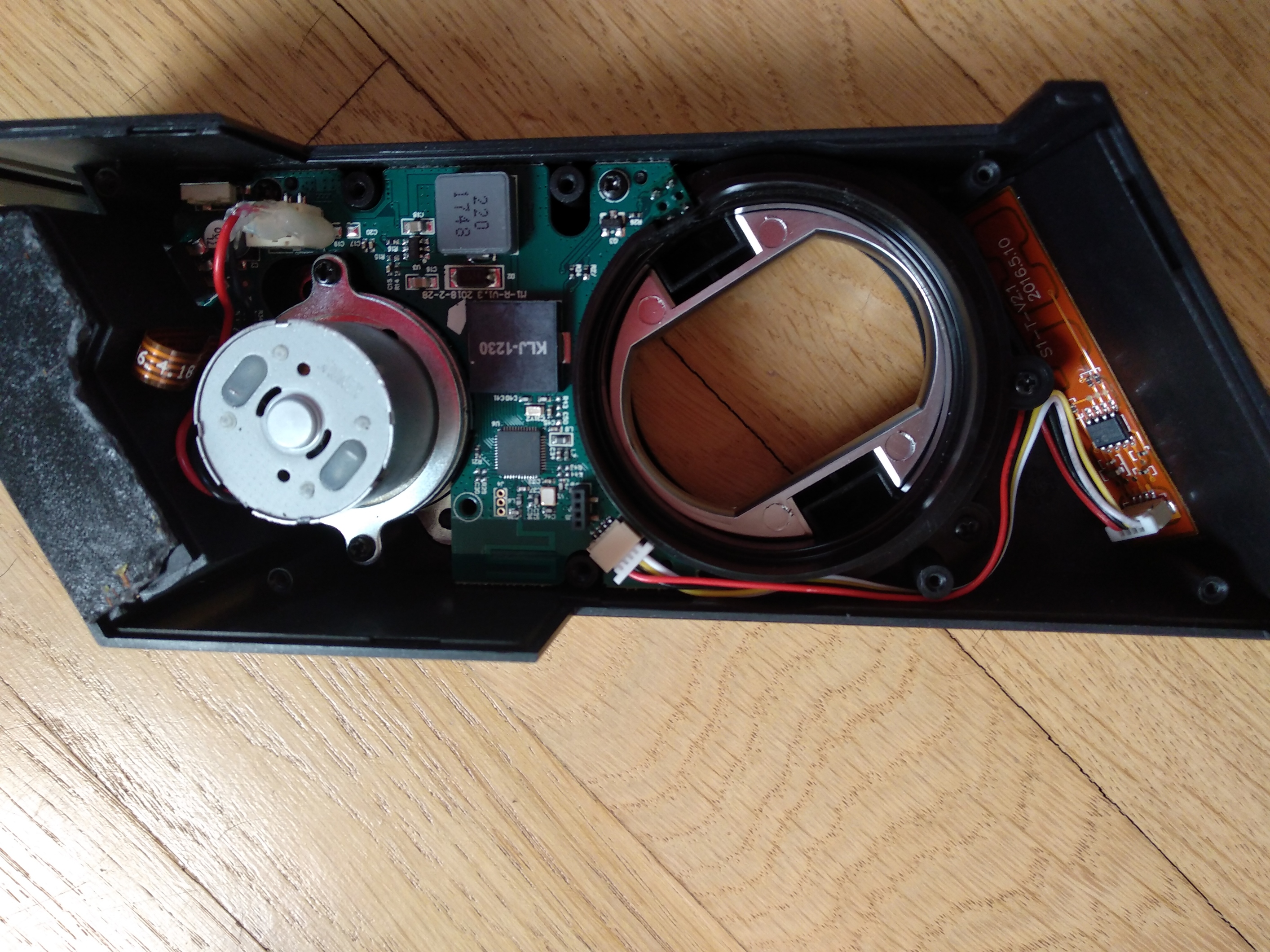

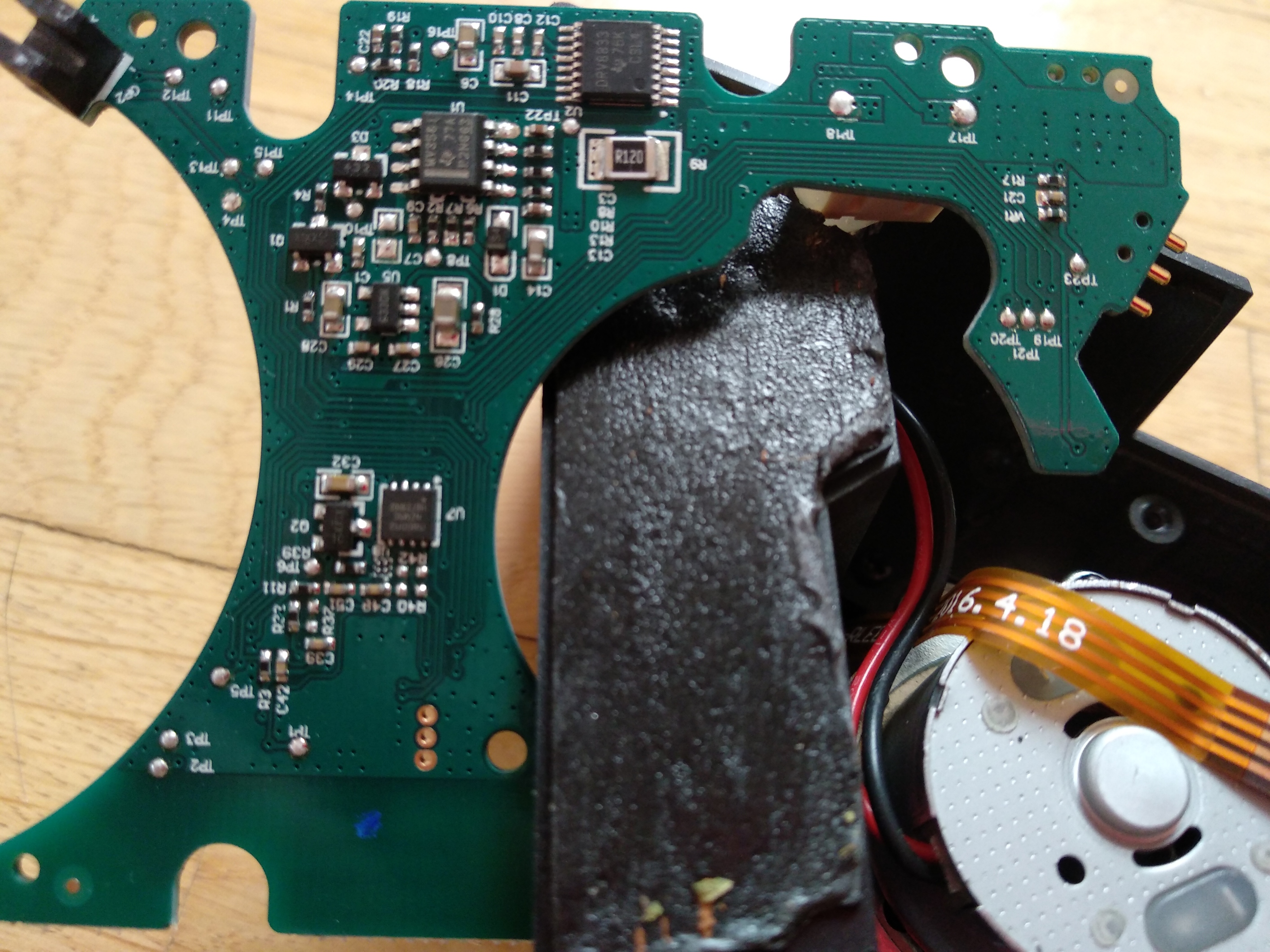

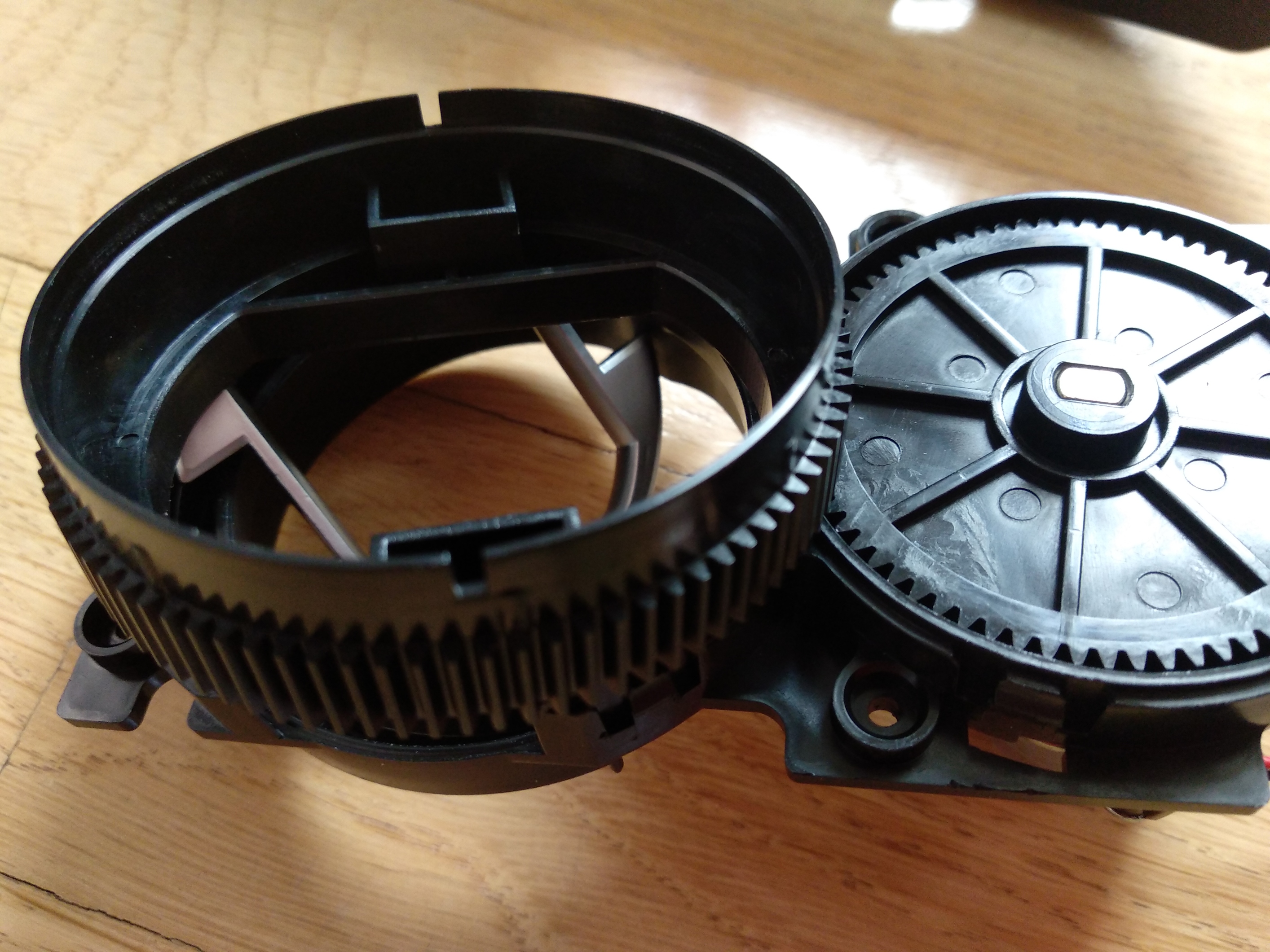

    I took some pictures while I took it apart, if you guys are interested let me know
can send me dissasembly pictures and board pictures? thanks
Here you go, it is not that difficult to get it open
