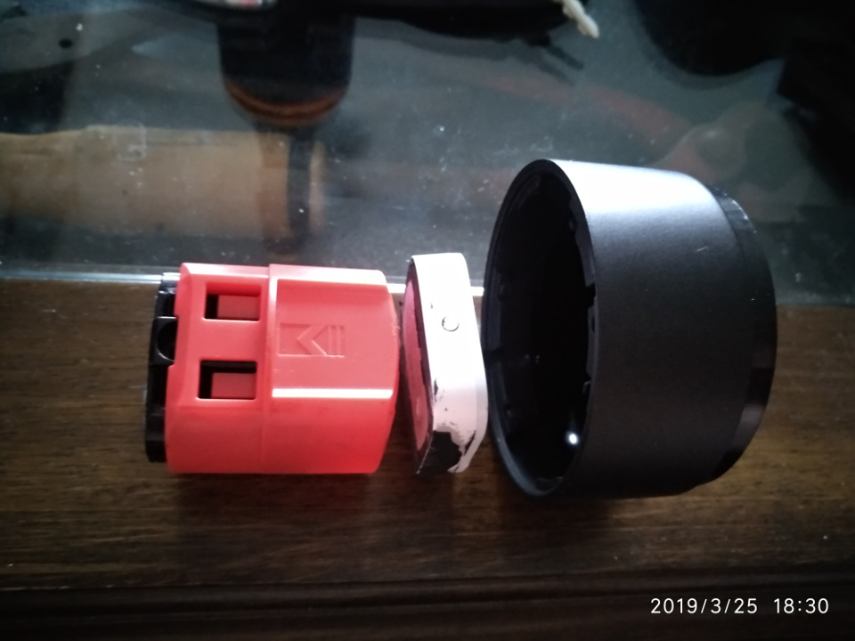

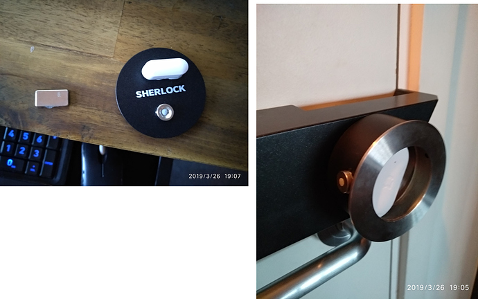

I tried to use this new Xiaomi sensor and I think it’s not possible. The sensor doesn’t have gyroscope so detecting rotation is very limited and unaccurate. I think that better solution is to use Xiaomi Door sensor. This sensor without shell fits perfect inside Sherlock key holder (I changed battery to bigger one):
and outside:
The very last rotation on lock and unlock event are different. I use Node-RED to detect time differences between last open-close event of Xiaomi Door Sensor and it works perfect for me.
Oh cool! This looks promising. I think I am close to a solution with the motion/vibration sensor though, but the door sensors are cheaper and smaller, so if they can be used, then that could be better.

One aesthetic tip (if you prefer), is that you can swap out the smaller sensor with another subtler looking (and even smaller) magnet. I tested with a few I had around and it worked fine. I guess smaller ones like in my photo could even fit on the inside, instead of outside like yours? Not sure if the super magnets I tested could interfere with the Sherlock though?
