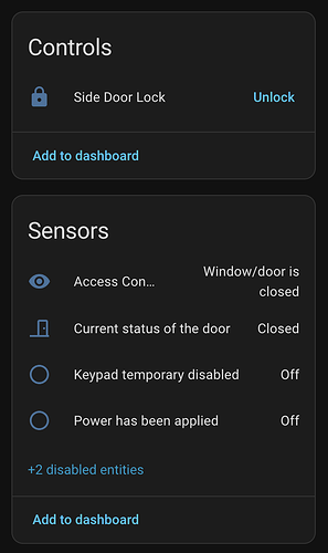

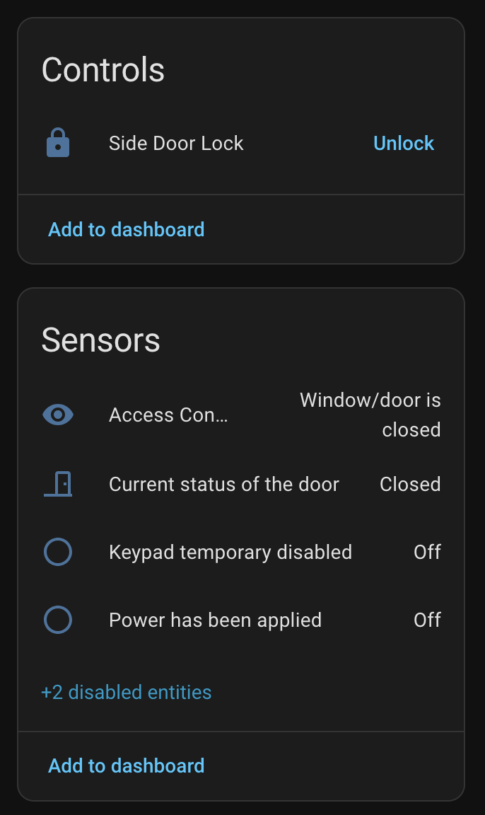

This thread helped me get the lock added successfully and the entities are showing up. The lock / unlock function works and changes to it show up immediately in the user interface. However, doorsense does not seem to work. I have two binary sensors that I think are meant to expose the doorsense status, but they never change when I open or close the door.
The Yale Access app shows the doorsense status changing, but the not the Home Assistant UI.
Has anyone run into this?
This seems to be a problem with older firmware on either the Zwave module or the lock itself. There a long thread of people figuring out what version works and doesn’t:
