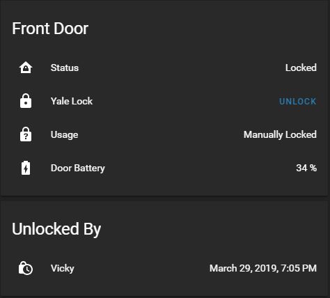

so i’ve had the z wave in for about 2 weeks and i love it
here is my lovelace set up
lock is reading 34% so it must be the new firmware. every happy
i have a script that i use on my phone (samsung remapped bixby) that when pressed unlocks my door which i press when pulling on my drive.
That’s great. What did you use to get the battery status in there?
Ah - a bit more research and I’ve found the zwave entity.
I find the battery level jumps up and down a few % but it’s good to see it’s not burning them out.
