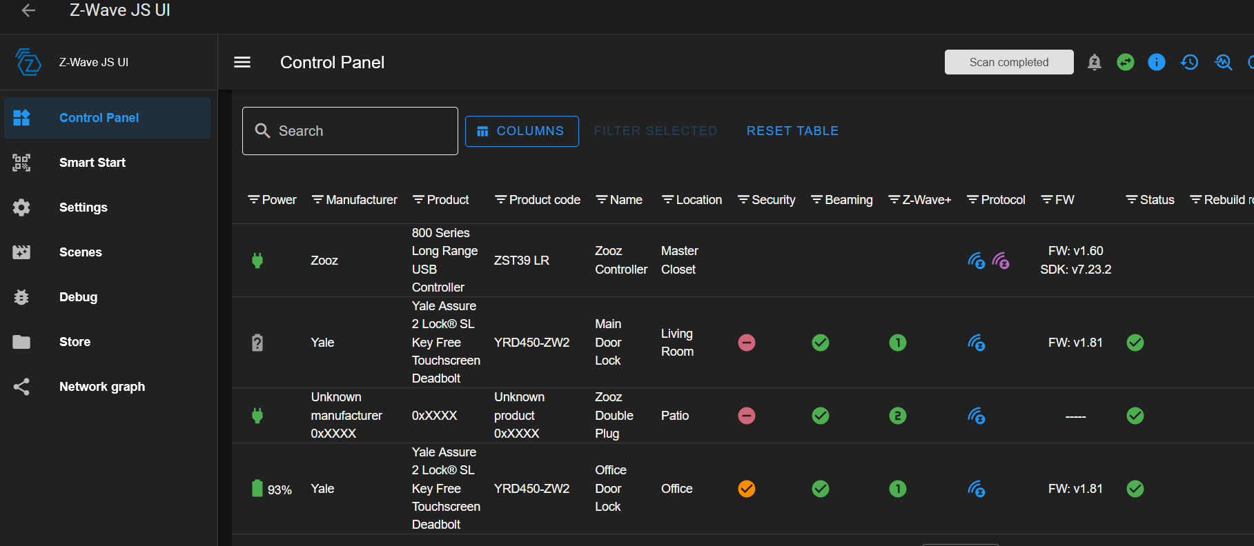

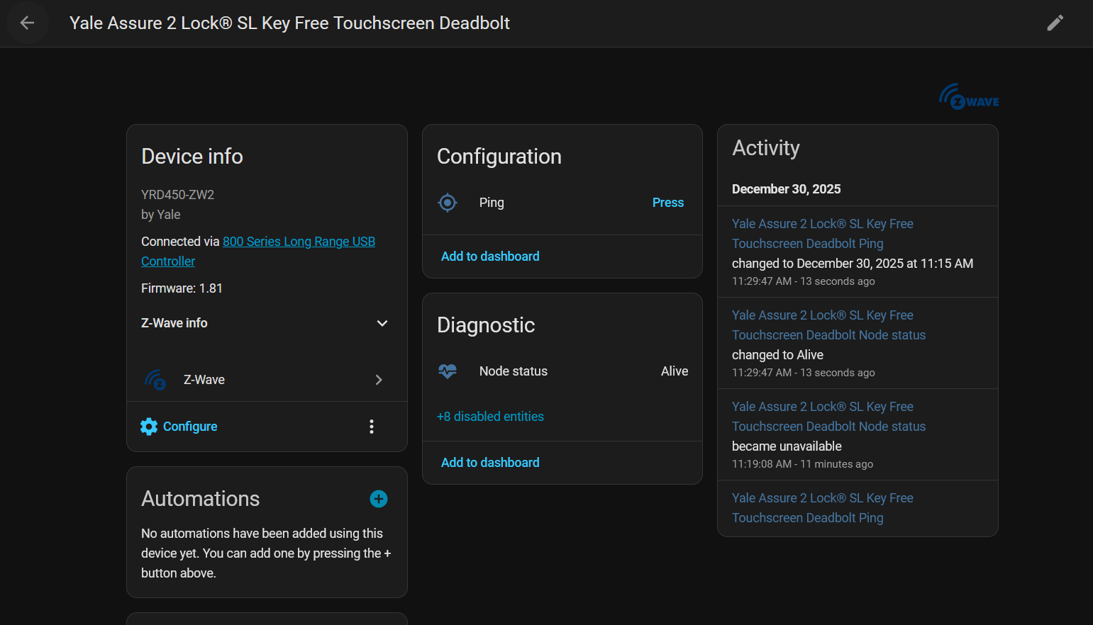

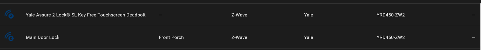

Good morning, I have two door locks. One I added two years ago and now I am adding another one. The Main Door Lock is Node 2 and has been active and working for a while. Now, Node 7 and the Office Door lock I only see a couple of limited entities that are not useful. I saw a post out there linked here so I followed along. Yale Assure 2 - ZWAVE - No useful entities - #26 by jaffacree
I have some pictures and a log entry added.
Love to know if any one has any idea. I stop Zwave JS and start Zwave JS UI, added the door lock and completed the interview. I stop Zwave JS UI and restart Zwave JS and the new door lock is there but I cannot control it like the other one.

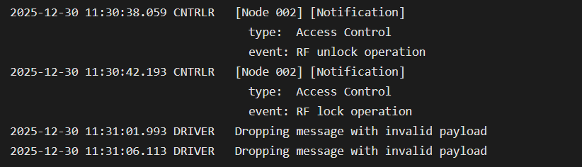

Node 2 shows the activity when manually turning the lock mechanism. The invalid payload is this new office lock.
