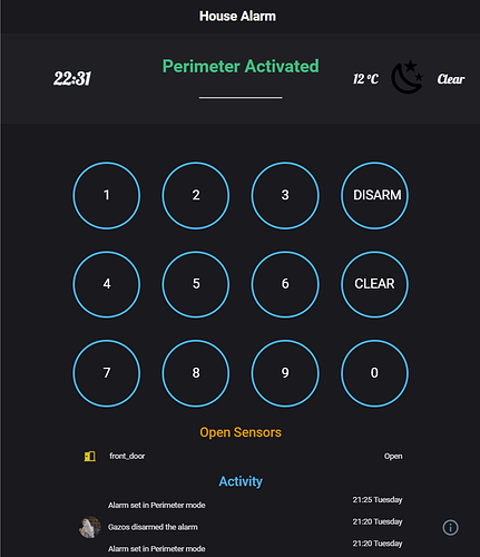

Hi Folks,
I’ve been out of action for a little while however I’m busy working on cleaning up the interface and implementing themes when I get a chance.
I’d appreciate some feedback on the images below. Hopefully the content is responsive enough for most if not all devices/resolutions (+landscape/potrait modes) and I’ll likely add some options in the settings popup to further customise the UI (force portrait/landscape, button shape etc)
The three buttons at the bottom allow you to show toggle between the keypad (in mobile mode), the log (if enabled with user specific codes and pictures), Sensor Groups and a settings page.

I’m pretty sure I can get floorplan to show as a statecard within this setup so that it removes the extra menu in the embedded window. I’ll take a look and get back to you. I also use floorplan and its awesome!
Nice! looking forward to the finished product. Nice work!!
Please share if you get it running properly. The new interface looks slick.
I’m so excited to try this new updated. Hope you upload soon.
I really like this new design. Would it be possible to add a password manager in the settings? It would be nice to be able to change user passwords and create passwords which only work between certain hours (for cleaning lady for example) via the web interface.
This is something I had been considering myself, the more we can edit in a user friendly settings menu the better especially with the WAF. Conscious this would need to be secured via an admin password.
Time based passwords would be great, I’ll add it to the list of things to add.
I have user passwords working with logging now.
