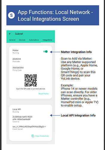

Speaking from my own experience, everything is working perfectly fine for me over Matter. I have no idea how to bring them in using MQTT or anything else(if it’s possible right now) so I just moved devices over to the Local Network and turned on Matter.
After that I commissioned the hub into HA and brought in all the devices attached to it. I blocked it from the Internet and everything still responds correctly and quickly in HA. In the Yolink app I get no updates though since it’s cloud dependent I guess.

How are you connecting over Matter? Yolink is wanting me to do something with JSON (that is the code on HA correct? I only use the gui as I am clueless on coding). I asked if they knew a way to do it with the GUI they said there is not.
Do you not see the option when you go into the Local Hub, click on Local Network at the bottom, and then go to “Integrations”?
That’s where it’s at in the app and when I toggle Matter on it gives me a QR code and the pairing number. So I just added it to Home Assistant that way.

When I try that it just says stopped under matter even though it shows toggled on.
And once the local hub is working and bug-free - and also possibly integrated into the HA integration - I rely upon the virtualarm service so I wonder it that goes out the window then… :frowning:

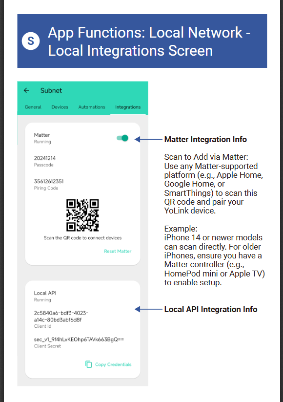

@madbrain @beamfarms This is a snapshot from Yolink’s online instruction manual. This is not my personal Local Hub information for anyone who might be worried for me.
Anyways, this is what I saw when I was in the app before. Ever since updating to 0606, the QR code doesn’t appear anymore. But the 11 digit pairing code is still there though.
Point is that I didn’t have to do anything extra, it was always available for me. So if it’s not there for you guys then you’re going to have to ask Yolink about that. Sorry I can’t be of more help.
That is a big help, thank you. I wonder why yolink did not mention Matter to me when I asked about away with out messing with json? Like I said mine just says matter stopped when I swipe it on. I’m going to try a few hard restarts and removing and adding the hub to my account a few times. I’m also going to ask yolink directly about matter.
Got it going with matter. I didn’t have any devices connected to the local hub. After adding a plug to matter it gave me the qr code. It works and with out internet although not as responsive as I would like. If I cycle it rapidly it gets out of sync but eventually catches itself. Hoping they eventually make a better easy way to sync it with HA.
