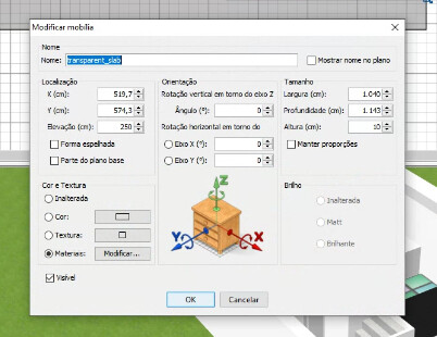

I never managed to get the transparent_slab to work, only with the ceiling activated. Do I have to put a transparent texture in the transparent_slab ? Or do I have to make it invisible in SweetHome3D? Or Solid? Is there an advised height for the slab?

transparent slab can be a box of 1 pixel height and it should be transparent without any texture

Well, I can’t get that; I tryied
- Only with ceiling:
- With transparent_slab:
- With transparent_slab AND Ceiling
(same result as with ceiling only, image in 1.)
Do you see anything wrong at first site with my settings?
