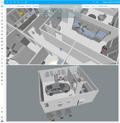

Hi
I can see somebody have used Browser mod for popup.
I could only do this with gesture and running a script with browser mod configuration.
This works great.
The problem is that browser mod popup shows on all screens.
I know that to get this work on active screen i have to use a fire-dom-event.
This i have not succided to configure with floor card and gesture.
Anybody who have an ide on how to do this ?
I do not know how to confine the browser mod popup to the active screen. It’s not really an issue for me, since I typically only have one screen open, but please let me know if you figure it out.
For what it’s worth, here’s the script for one of my popup cards.

Yes this is something similar to what i have.
But it popup on all screens.
Yes i will tell you if i figure it out.
For now i have set a destination inside the script and the dashboard link is opened with ?BrowserID=Dashboard in the end ,this will be the name of the registered browser , in this way popup always shows on that screen.
But in this way if i want to show the popup on a other screen it will not work.
I think this will have a simple answer.

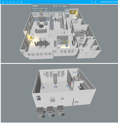

I have a light object that has been split into 52 separate objects:
KitchenCeilingLight_1 to KitchenCeilingLight_52
If I click on the light object, I could get any of these 52 objects. For my first attempt at setting this object up, I am linking to just 1 of these.
  - entity: light.kitchen_ceiling_bulbs
    type3d: light
    object_id: KitchenCeilingLight_1
    light:
      lumens: "1500"
If I click KitchenCeilingLight_1 or indeed turn it on via the entity itself, the light on the plan does turn on.
I would like to have as little code as possible so do not want 51 copies of this.
I realise there is an object group. Can I add these to a single group and use the group name instead. eg
  - object_group: KitchenCeilingLights
    objects:
      - object_id: KitchenCeilingLight_1
      - object_id: KitchenCeilingLight_52
    type3d: light
    object_id: KitchenCeilingLights
    light:
      lumens: "1500"
I ask the question because I tried it and it did not seem to even show any light in the plan when I turned on the light but did not have errors when loading
This should be bracketed with greater-than and less-than signs:
object_id: <KitchenCeilingLights>
Not sure if case matters, but perhaps keep everything lower case, e.g. kitchenceilinglights, as well.
Thanks that sorted it.
