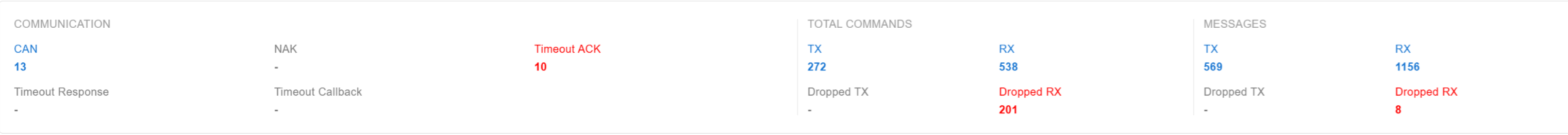

The controller statistics are as follows .
For the commands, that’s quite a few dropped RX. What could be causing this ?
I there an expected range of errors in terms of percentage of all commands on a working system ? Also, interestingly, there are no dropped TX for either commands or messages.
I’d really like to look at the RSSI for each node, but still can’t find it in ZUI.
Commands dropped RX is defined as “No. of commands from the node that were dropped by the host”. It looks like these are currently related to S2 messages that can’t be decoded. Either the message authentication has not yet been established (e.g. there was a Z-Wave JS restart and this is first time communication) or the message was corrupted. Some of these will correspond to log messages that contain cannot decode command. Of those logs, some will always occur after a restart of Z-Wave JS when it talks to a node for the first time (No SPAN is established yet). Other dropped messages will be logged with Dropping message and you’ll probably see that followed by Security2CCMessageEncapsulation error message.
Probably depends, but with an uptime of 2 weeks I have 96 dropped RX (out of 37,759 total).
I just checked why I had 96 dropped and 76 of them were from a single node freaking out and spamming retry messages (Duplicate command), ultimately jamming the controller and causing a soft-reset (which recovered). That was the first time I’ve observed a jammed controller. So excluding that I’d have 20 dropped commands over 2 weeks and 14 of those would be due to a Z-Wave JS restart.

The dropped RX have doubled to 488 since my last post, which was only about an hour ago, when it was 200. So, almost 300 in one more, way more than you are getting in 2 weeks of uptime ! And that is out of 922 total, so 53% of the total commands RX are getting dropped !
