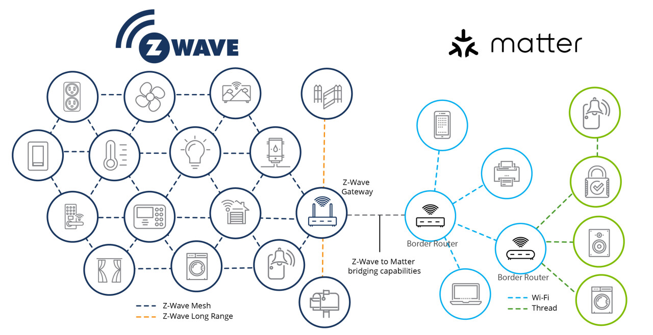

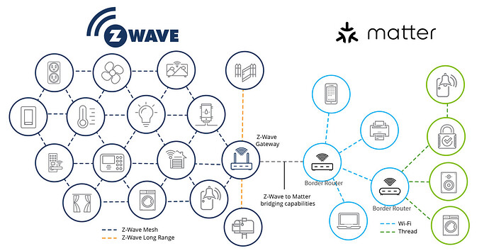

You should regardless first aim to build out your Z-Wave network mesh as non-LR devices depends on mesh networking. Meaning that you just need to buy and add more mains-powered Z-Wave devices what act as repeaters which will extend the total range of your Z-Wave network mesh by connecting devices further away using other mains-operated Z-Wave devices as repeaters.
I recommend that you read my best-practices guide linked below on Zigbee network optimization as most of the generic mesh networking tips there also applies to Z-Wave because they both heavily depend on mesh networking, so if you do not only have Z-Wave Long Range devices you also need to build out your Z-Wave mesh network as well by simply adding more mains-powered Z-Wave devices to it. The guide also include other general tips on optimal placement and things that apply to all wireless devices because of how all radio signals work.

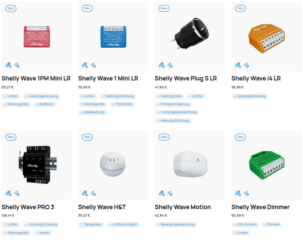

Shelly offers a bunch of LR devices now which have been added to their product portfolio just shortly.
Can only see 1 on their site?
Edit: 4.
But they are just existing mains powered one’s LR’d
Edit2: 8
Some habe “LR” in description, some have another icon in the picture and describe long range in the description.
Final verdict: 8 shelly long range devices now.
Why qould one even keep buying “non-LR” then ![]()
Wow - great documentation - thanks for that!
I’ve already implemented this in our house using additional Z-Wave devices (light switches, smoke detectors, plug adapters), and it works quite well.
My problem involves two open/close sensors - a) one installed in a garden shed about 50 meters away, and b) the other in a garage adjacent to the house (there are several thick walls in between).
In both cases, I have no way of supplementing the mesh with additional devices. That’s why I’m so interested in the ZWA-2.
