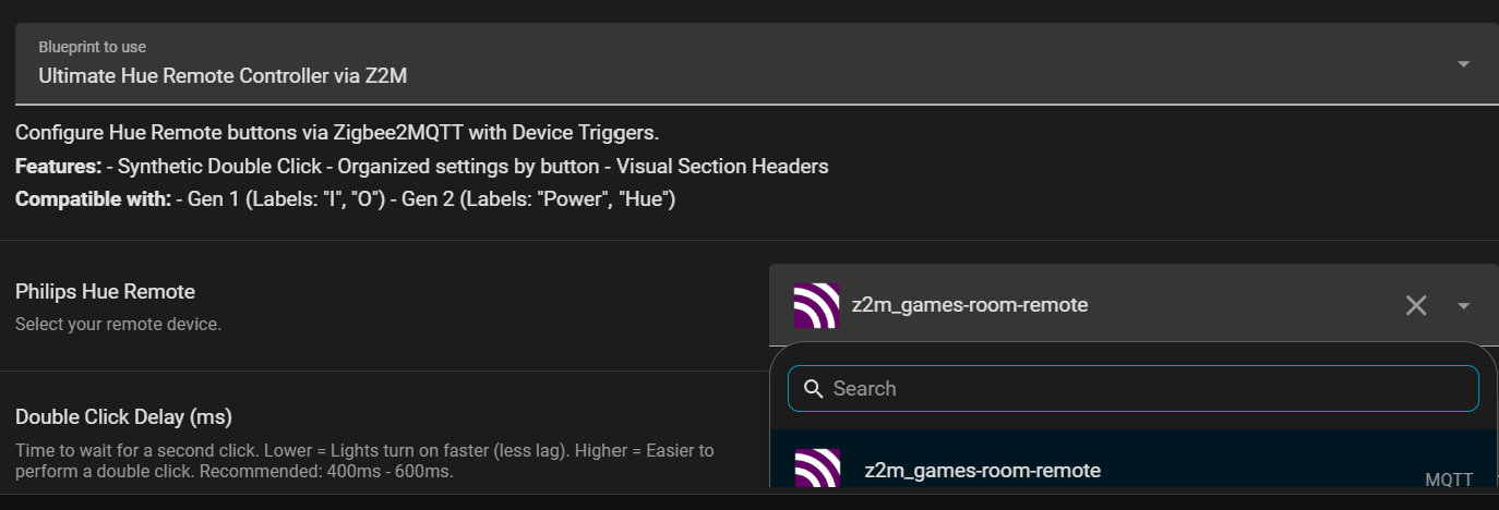

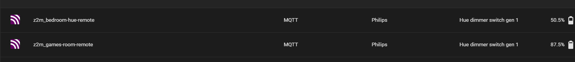

Hello, really enjoying this blueprint for my main remote, just tried to setup a second z2m remote with it though and I’m having some issues.

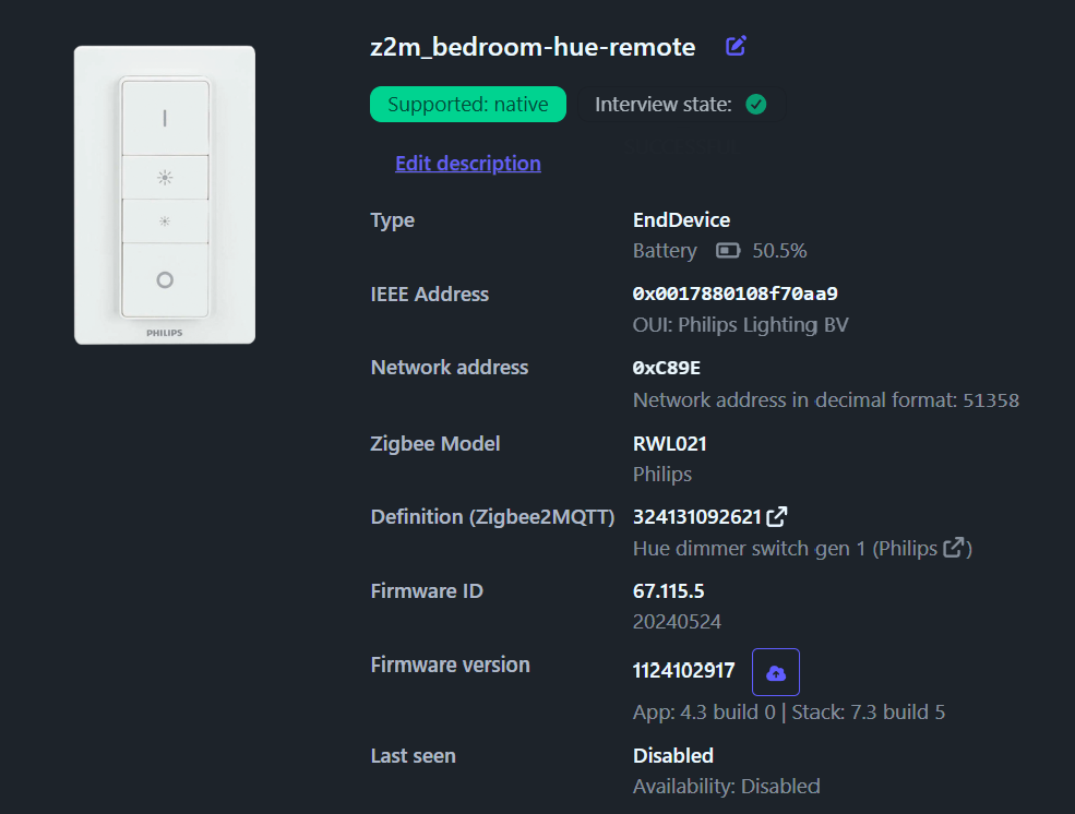

The remote for my bedroom doesnt show as an option. It is connected via zigbee and working fine.
My working remote is exactly the same model and firmware as the bedroom hue remote, However the bedroom hue remote doesnt appear to as an option in the blueprint when I try to amend the existing automation, or when I start a new automation.

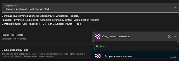

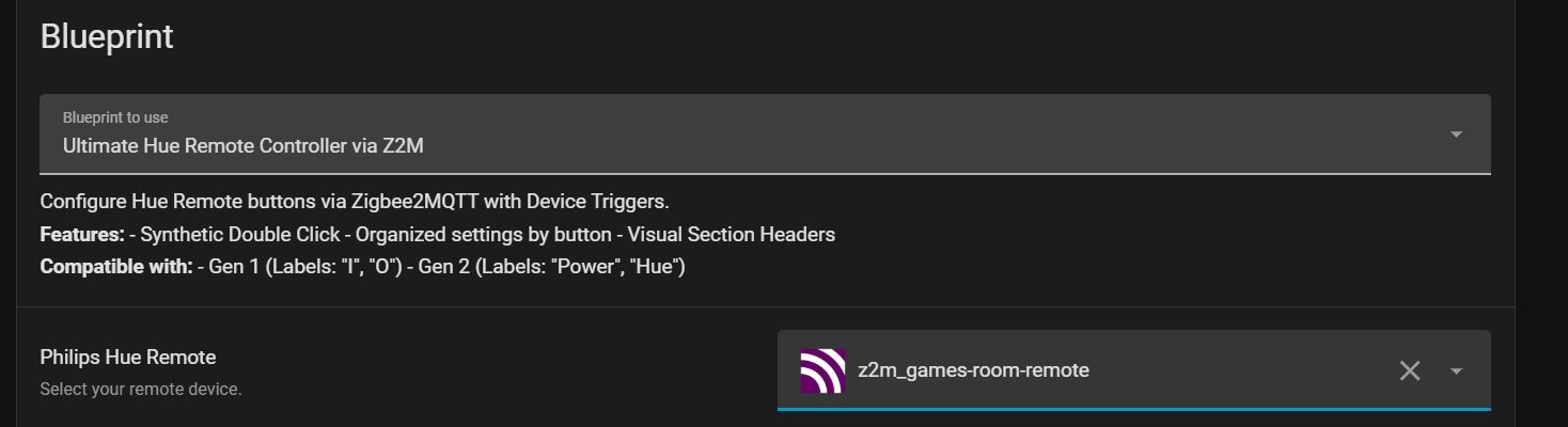

Working automation:

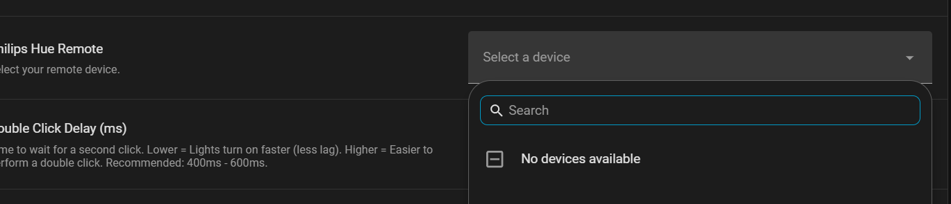

New automation:
I can see the device trigger events being captured, and can create manual automations for the triggers.
Both devices do show up in the MQTT integration
Any help would be appreciated, I did this in the middle of an evening before going to bed… a big song and dance trying to turn off my lamps without any button! :slight_smile:

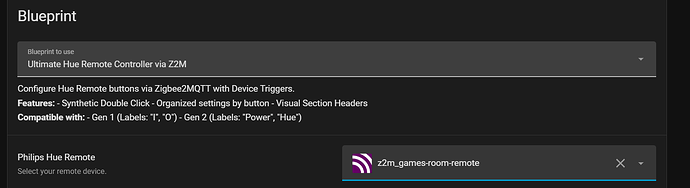

Further update, something strange happening.
This is my existing blueprint, if I remove this device… I can no longer re-add it.
I havent saved, and the blueprint automation continues to work.
Is there a way I can get the remote ID?

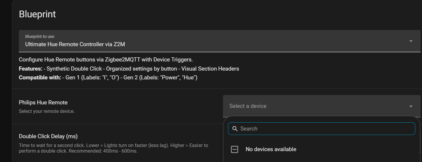

I’m not sure if anybody else is experiencing this, but today this blueprint seems to stop recognising a single press on the Philips Hue Dimmer Switch, instead registering the single button presses as double presses. Has anybody else experienced this?
EDIT: @1mvdb it seems that updating Mosquitto broker from 6.5.2 to 7.0.0 causes this behaviour as that was the only thing I updated since yesterday. Rolling back to 6.5.2 fixed my automations using this blueprint, so something in 7.0.0 seems to be breaking this.
I had a similar issue, none of my remotes appeared in the list of devices when creating the automation. The issue is that the blueprint uses a strict model filter. I fixed it by editing the selector in the blueprint yaml. The original yaml file uses Hue dimmer switch as model, but the model definition in HA’s devices for my remotes is Hue dimmer switch gen 2. So I changed the selector in the yaml file like this and now it works:
      selector:
        device:
          integration: mqtt
          manufacturer: Philips
          model: Hue dimmer switch gen 2
          multiple: false
Seems to work fine here. I’m using z2m 2.9.2 and Mosquito broker 7.0.1.
Same issue here since Mosquitto 7.0.0. Persists on 7.1.0. Every interaction with the Hue dimmer switch gen 1 is registered as a double-press. I adjusted the blueprint’s device selector to enable support for these models, which worked until version 6.5.2. Since @dasku11 reports that Gen 2 is working correctly, this may be an issue specific to the Gen 1 model.
@raspberrycoulis Which model are your switches?
Sorry for the delay, didn’t get a notification. My dimmers are gen 1 I think. Button presses don’t seem to be differentiating the button presses correctly - often sees them as double presses as pressing the button once, triggers the scene I had configured for the double press.
I have similar issue. I've tried to set model to Hue dimmer switch gen 1 but it doesn't work.
Mosquitto broker : 7.1.0
Z2M : 2.10.1
Thanks! Don't forget to trigger the Reload Automation service so that the changes take effect (Developer Tools, Actions, Reload Automations)
I updated Mosquitto today and restarted Z2M and the issue seems to be solved.
