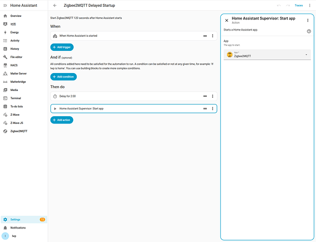

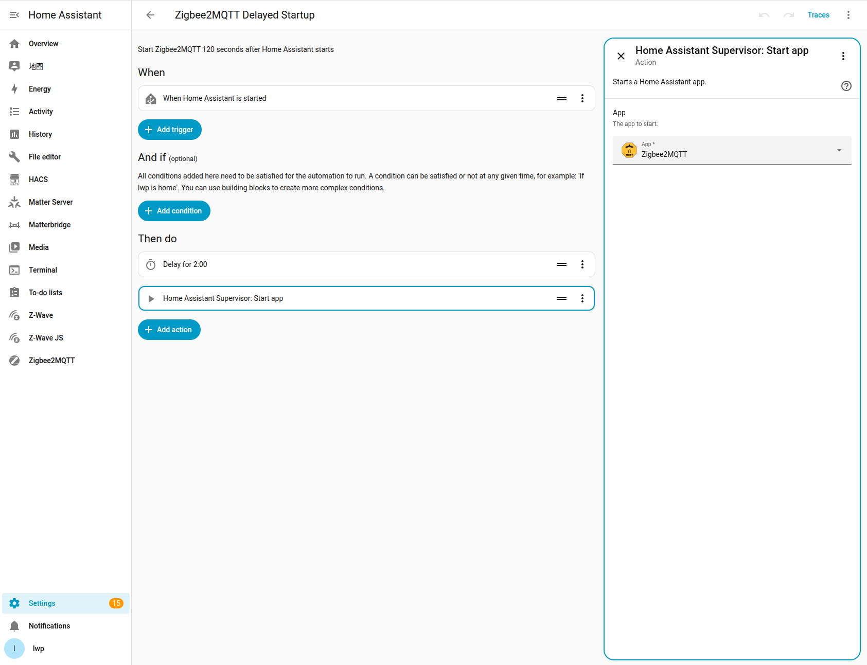

Hi SergeyT,
I believe the problem is related to the network startup sequence after a power outage.
You can create a Home Assistant automation to delay the startup of Zigbee2MQTT by 2 minutes.
First, disable “Start on boot” in the Zigbee2MQTT add-on settings.
Then, create a new automation using the following YAML:
alias: Zigbee2MQTT Delayed Startup
description: Start Zigbee2MQTT 120 seconds after Home Assistant starts
triggers:
  - trigger: homeassistant
    event: start
conditions: []
actions:
  - delay:
      hours: 0
      minutes: 2
      seconds: 0
  - action: hassio.app_start
      app: 45df7312_zigbee2mqtt
mode: single
Make sure to replace 45df7312_zigbee2mqtt with your actual Zigbee2MQTT add-on slug if it is different.
Hope this helps!
