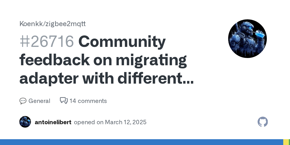

In summery I think that guides for migratiing between radios in Zigbee2MQTT belongs in the Z2M community forum instead → Koenkk/zigbee2mqtt · Discussions · GitHub
Or perhaps better yet, consider updating their website FAQs and/or adding articles there too in order to extend the official Zigbee2mqtt documentation → GitHub - Koenkk/zigbee2mqtt.io: 📘 Zigbee2mqtt documentation
