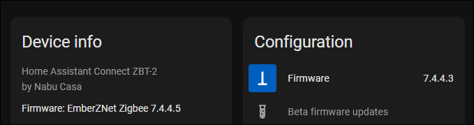

I installed the latest zigbee firmware using the web flasher, then the installation went through. Zigbee network is stabilizing as we speak.

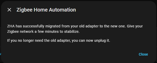

Thanks. This did the trick
yes, this worked - thanks! Migration from the old adapter is completed

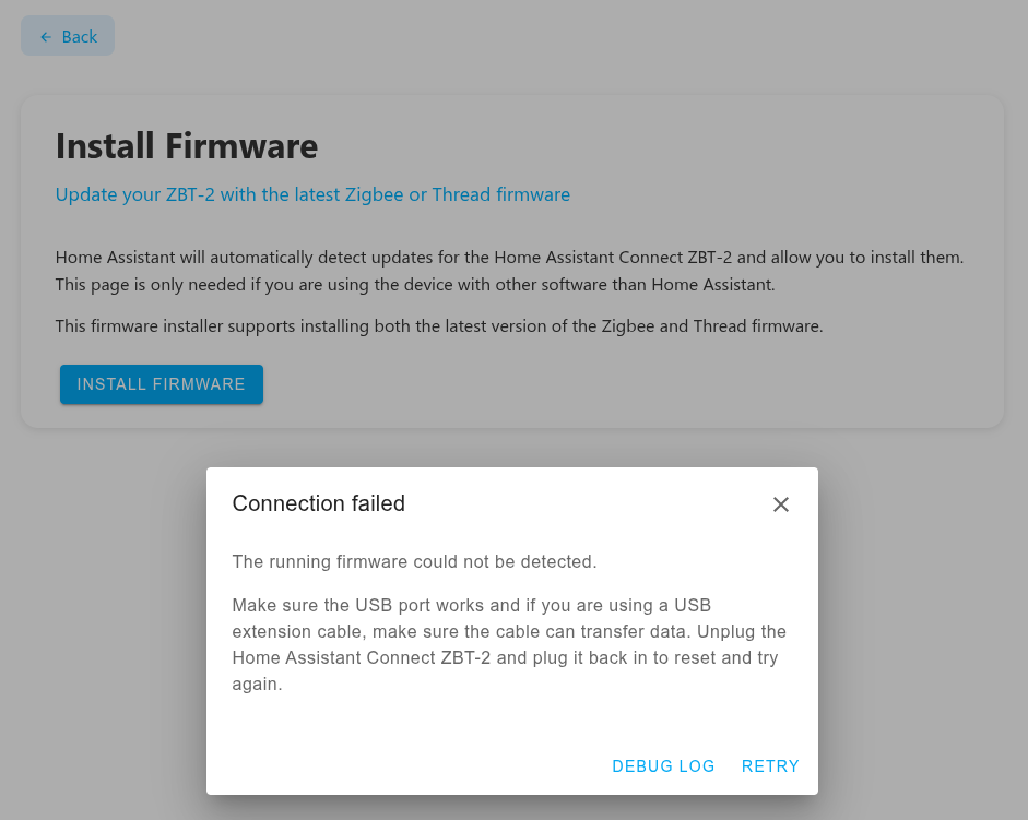

I’m having the same issue, tried a few times and trying to Flash from HA fails, the web flasher seems to be flashing now… :crossed_fingers:
  1. Updated firmware manually and it still failed.
  2. Did a hard reboot and still failed.
  3. Decided to reboot again… It worked!
  4. If you have a ZBT-1 (original dongle) leave it plugged in so the software can reset it.
    All working now. with strong signals :smiley:

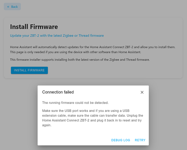

Over here the firmware cannot be installed neither via HA OS nor via the web flasher. After a HA reboot it is auto-discovered again.

web flasher
silabs_flasher.log
2025-11-21 15:44:43 emscripten zigpy.appdb[42] DEBUG SQLite version for <webserial_transport.MockSqlite3 object at 0x11892e0>: 3.31.1
2025-11-21 15:44:43 emscripten universal_silabs_flasher.flasher[42] INFO Triggering rts_dtr bootloader
2025-11-21 15:44:43 emscripten webserial_transport[42] DEBUG Opening a serial connection at 115200 with rtscts=False
2025-11-21 15:44:43 emscripten zigpy.serial[42] DEBUG Connection made: <webserial_transport.WebSerialTransport object at 0x1ccccb8>
2025-11-21 15:44:43 emscripten universal_silabs_flasher.common[42] DEBUG Setting UART signals: rts=1, cts=-, dtr=0
2025-11-21 15:44:43 emscripten universal_silabs_flasher.common[42] DEBUG Setting UART signals: rts=0, cts=-, dtr=1
2025-11-21 15:44:44 emscripten universal_silabs_flasher.common[42] DEBUG Setting UART signals: rts=0, cts=-, dtr=0
2025-11-21 15:44:44 emscripten zigpy.serial[42] DEBUG Waiting for serial port to close
2025-11-21 15:44:44 emscripten webserial_transport[42] DEBUG Closing serial port
2025-11-21 15:44:44 emscripten webserial_transport[42] DEBUG Closed serial port
2025-11-21 15:44:44 emscripten zigpy.serial[42] DEBUG Connection lost: None
2025-11-21 15:44:44 emscripten universal_silabs_flasher.flasher[42] INFO Triggering baudrate bootloader
2025-11-21 15:44:44 emscripten webserial_transport[42] DEBUG Opening a serial connection at 150 with rtscts=False
2025-11-21 15:44:44 emscripten zigpy.serial[42] DEBUG Connection made: <webserial_transport.WebSerialTransport object at 0x1ce3430>
2025-11-21 15:44:44 emscripten webserial_transport[42] DEBUG Opening a serial connection at 300 with rtscts=False
2025-11-21 15:44:44 emscripten zigpy.serial[42] DEBUG Connection made: <webserial_transport.WebSerialTransport object at 0x1ce3388>
2025-11-21 15:44:44 emscripten webserial_transport[42] DEBUG Opening a serial connection at 1200 with rtscts=False
2025-11-21 15:44:44 emscripten zigpy.serial[42] DEBUG Connection made: <webserial_transport.WebSerialTransport object at 0x1d53908>
2025-11-21 15:44:48 emscripten webserial_transport[42] DEBUG Opening a serial connection at 115200 with rtscts=False
2025-11-21 15:44:48 emscripten zigpy.serial[42] DEBUG Connection made: <webserial_transport.WebSerialTransport object at 0x1be9d78>
2025-11-21 15:44:48 emscripten universal_silabs_flasher.gecko_bootloader[42] DEBUG Sending data b’\n’
2025-11-21 15:44:48 emscripten universal_silabs_flasher.gecko_bootloader[42] DEBUG Sending data GeckoBootloaderOption.EBL_INFO
2025-11-21 15:44:50 emscripten zigpy.serial[42] DEBUG Waiting for serial port to close
2025-11-21 15:44:50 emscripten webserial_transport[42] DEBUG Closing serial port
2025-11-21 15:44:50 emscripten webserial_transport[42] DEBUG Closed serial port
2025-11-21 15:44:50 emscripten zigpy.serial[42] DEBUG Connection lost: None
2025-11-21 15:44:50 emscripten universal_silabs_flasher.flasher[42] INFO Probing ApplicationType.GECKO_BOOTLOADER at 115200 baud
2025-11-21 15:44:50 emscripten webserial_transport[42] DEBUG Opening a serial connection at 115200 with rtscts=False
2025-11-21 15:44:50 emscripten zigpy.serial[42] DEBUG Connection made: <webserial_transport.WebSerialTransport object at 0x1bb3440>
2025-11-21 15:44:50 emscripten universal_silabs_flasher.gecko_bootloader[42] DEBUG Sending data b’\n’
2025-11-21 15:44:50 emscripten universal_silabs_flasher.gecko_bootloader[42] DEBUG Sending data GeckoBootloaderOption.EBL_INFO
2025-11-21 15:44:52 emscripten zigpy.serial[42] DEBUG Waiting for serial port to close
2025-11-21 15:44:52 emscripten webserial_transport[42] DEBUG Closing serial port
2025-11-21 15:44:52 emscripten webserial_transport[42] DEBUG Closed serial port
2025-11-21 15:44:52 emscripten zigpy.serial[42] DEBUG Connection lost: None
2025-11-21 15:44:52 emscripten universal_silabs_flasher.flasher[42] DEBUG Probe timed out
2025-11-21 15:44:52 emscripten universal_silabs_flasher.flasher[42] INFO Probing ApplicationType.EZSP at 460800 baud
2025-11-21 15:44:52 emscripten webserial_transport[42] DEBUG Opening a serial connection at 460800 with rtscts=False
2025-11-21 15:44:52 emscripten zigpy.serial[42] DEBUG Connection made: <bellows.ash.AshProtocol object at 0x1d0b058>
2025-11-21 15:44:52 emscripten bellows.ezsp[42] DEBUG Resetting EZSP
2025-11-21 15:44:52 emscripten bellows.uart[42] DEBUG Resetting ASH
2025-11-21 15:44:52 emscripten bellows.ash[42] DEBUG Sending frame 32CANCEL RstFrame() FLAG
2025-11-21 15:44:52 emscripten bellows.ash[42] DEBUG Sending data 1a1a1a1a1a1a1a1a1a1a1a1a1a1a1a1a1a1a1a1a1a1a1a1a1a1a1a1a1a1a1a1ac038bc7e
2025-11-21 15:44:54 emscripten bellows.ezsp[42] DEBUG EZSP startup/reset failed, retrying (1/3): TimeoutError()
2025-11-21 15:44:54 emscripten bellows.ezsp[42] DEBUG Resetting EZSP
2025-11-21 15:44:54 emscripten bellows.uart[42] DEBUG Resetting ASH
2025-11-21 15:44:54 emscripten bellows.ash[42] DEBUG Sending frame 32
2025-11-21 15:44:54 emscripten bellows.ash[42] DEBUG Sending data 1a1a1a1a1a1a1a1a1a1a1a1a1a1a1a1a1a1a1a1a1a1a1a1a1a1a1a1a1a1a1a1ac038bc7e
2025-11-21 15:44:57 emscripten bellows.ezsp[42] DEBUG EZSP startup/reset failed, retrying (2/3): TimeoutError()
2025-11-21 15:44:57 emscripten bellows.ezsp[42] DEBUG Resetting EZSP
2025-11-21 15:44:57 emscripten bellows.uart[42] DEBUG Resetting ASH
2025-11-21 15:44:57 emscripten bellows.ash[42] DEBUG Sending frame 32CANCEL RstFrame() FLAG
2025-11-21 15:44:57 emscripten bellows.ash[42] DEBUG Sending data 1a1a1a1a1a1a1a1a1a1a1a1a1a1a1a1a1a1a1a1a1a1a1a1a1a1a1a1a1a1a1a1ac038bc7e
2025-11-21 15:44:59 emscripten zigpy.serial[42] DEBUG Waiting for serial port to close
2025-11-21 15:44:59 emscripten webserial_transport[42] DEBUG Closing serial port
2025-11-21 15:44:59 emscripten webserial_transport[42] DEBUG Closed serial port
2025-11-21 15:44:59 emscripten zigpy.serial[42] DEBUG Connection lost: None
2025-11-21 15:44:59 emscripten bellows.uart[42] DEBUG Connection lost: None
2025-11-21 15:44:59 emscripten universal_silabs_flasher.flasher[42] DEBUG Probe timed out
2025-11-21 15:44:59 emscripten universal_silabs_flasher.flasher[42] INFO Probing ApplicationType.SPINEL at 460800 baud
2025-11-21 15:44:59 emscripten webserial_transport[42] DEBUG Opening a serial connection at 460800 with rtscts=False
2025-11-21 15:44:59 emscripten zigpy.serial[42] DEBUG Connection made: <webserial_transport.WebSerialTransport object at 0x1de4140>
2025-11-21 15:44:59 emscripten universal_silabs_flasher.spinel[42] DEBUG Sending frame SpinelFrame(header=SpinelHeader(transaction_id=0, network_link_id=0, flag=2), command_id=<CommandID.RESET: 1>, data=b’\x02’)
2025-11-21 15:44:59 emscripten universal_silabs_flasher.spinel[42] DEBUG Sending data b’~\x80\x01\x02\xea\xf0~’
2025-11-21 15:45:01 emscripten universal_silabs_flasher.spinel[42] DEBUG Device did not respond to reset, continuing
2025-11-21 15:45:01 emscripten universal_silabs_flasher.spinel[42] DEBUG Sending frame SpinelFrame(header=SpinelHeader(transaction_id=3, network_link_id=0, flag=2), command_id=<CommandID.PROP_VALUE_GET: 2>, data=b’\x02’)
2025-11-21 15:45:01 emscripten universal_silabs_flasher.spinel[42] DEBUG Sending data b’~\x83\x02\x02\xe65~’
2025-11-21 15:45:03 emscripten universal_silabs_flasher.spinel[42] DEBUG Failed to send SpinelFrame(header=SpinelHeader(network_link_id=0, flag=2), command_id=<CommandID.PROP_VALUE_GET: 2>, data=b’\x02’), trying again in 0.10s (attempt 1 of 3)
2025-11-21 15:45:03 emscripten universal_silabs_flasher.spinel[42] DEBUG Sending frame SpinelFrame(header=SpinelHeader(transaction_id=3, network_link_id=0, flag=2), command_id=<CommandID.PROP_VALUE_GET: 2>, data=b’\x02’)
2025-11-21 15:45:03 emscripten universal_silabs_flasher.spinel[42] DEBUG Sending data b’~\x83\x02\x02\xe65~’
2025-11-21 15:45:05 emscripten universal_silabs_flasher.spinel[42] DEBUG Failed to send SpinelFrame(header=SpinelHeader(network_link_id=0, flag=2), command_id=<CommandID.PROP_VALUE_GET: 2>, data=b’\x02’), trying again in 0.10s (attempt 2 of 3)
2025-11-21 15:45:05 emscripten universal_silabs_flasher.spinel[42] DEBUG Sending frame SpinelFrame(header=SpinelHeader(transaction_id=3, network_link_id=0, flag=2), command_id=<CommandID.PROP_VALUE_GET: 2>, data=b’\x02’)
2025-11-21 15:45:05 emscripten universal_silabs_flasher.spinel[42] DEBUG Sending data b’~\x83\x02\x02\xe65~’
2025-11-21 15:45:07 emscripten universal_silabs_flasher.spinel[42] DEBUG Failed to send SpinelFrame(header=SpinelHeader(network_link_id=0, flag=2), command_id=<CommandID.PROP_VALUE_GET: 2>, data=b’\x02’), trying again in 0.10s (attempt 3 of 3)
2025-11-21 15:45:07 emscripten zigpy.serial[42] DEBUG Waiting for serial port to close
2025-11-21 15:45:07 emscripten webserial_transport[42] DEBUG Closing serial port
2025-11-21 15:45:08 emscripten webserial_transport[42] DEBUG Closed serial port
2025-11-21 15:45:08 emscripten zigpy.serial[42] DEBUG Connection lost: None
2025-11-21 15:45:08 emscripten universal_silabs_flasher.flasher[42] DEBUG Probe timed out
2025-11-21 15:45:28 emscripten zigpy.appdb[42] DEBUG SQLite version for <webserial_transport.MockSqlite3 object at 0x1203fd0>: 3.31.1
2025-11-21 15:45:28 emscripten universal_silabs_flasher.flasher[42] INFO Triggering rts_dtr bootloader
2025-11-21 15:45:28 emscripten webserial_transport[42] DEBUG Opening a serial connection at 115200 with rtscts=False
2025-11-21 15:45:28 emscripten zigpy.serial[42] DEBUG Connection made: <webserial_transport.WebSerialTransport object at 0x1d54310>
2025-11-21 15:45:28 emscripten universal_silabs_flasher.common[42] DEBUG Setting UART signals: rts=1, cts=-, dtr=0
2025-11-21 15:45:28 emscripten universal_silabs_flasher.common[42] DEBUG Setting UART signals: rts=0, cts=-, dtr=1
2025-11-21 15:45:29 emscripten universal_silabs_flasher.common[42] DEBUG Setting UART signals: rts=0, cts=-, dtr=0
2025-11-21 15:45:29 emscripten zigpy.serial[42] DEBUG Waiting for serial port to close
2025-11-21 15:45:29 emscripten webserial_transport[42] DEBUG Closing serial port
2025-11-21 15:45:29 emscripten webserial_transport[42] DEBUG Closed serial port
2025-11-21 15:45:29 emscripten zigpy.serial[42] DEBUG Connection lost: None
2025-11-21 15:45:29 emscripten universal_silabs_flasher.flasher[42] INFO Triggering baudrate bootloader
2025-11-21 15:45:29 emscripten webserial_transport[42] DEBUG Opening a serial connection at 150 with rtscts=False
2025-11-21 15:45:29 emscripten zigpy.serial[42] DEBUG Connection made: <webserial_transport.WebSerialTransport object at 0x1bc85d8>
2025-11-21 15:45:29 emscripten webserial_transport[42] DEBUG Opening a serial connection at 300 with rtscts=False
2025-11-21 15:45:29 emscripten zigpy.serial[42] DEBUG Connection made: <webserial_transport.WebSerialTransport object at 0x1d7c8c0>
2025-11-21 15:45:29 emscripten webserial_transport[42] DEBUG Opening a serial connection at 1200 with rtscts=False
2025-11-21 15:45:29 emscripten zigpy.serial[42] DEBUG Connection made: <webserial_transport.WebSerialTransport object at 0x1b9bd60>
2025-11-21 15:45:33 emscripten webserial_transport[42] DEBUG Opening a serial connection at 115200 with rtscts=False
2025-11-21 15:45:33 emscripten zigpy.serial[42] DEBUG Connection made: <webserial_transport.WebSerialTransport object at 0x1dddd48>
2025-11-21 15:45:33 emscripten universal_silabs_flasher.gecko_bootloader[42] DEBUG Sending data b’\n’
2025-11-21 15:45:33 emscripten universal_silabs_flasher.gecko_bootloader[42] DEBUG Sending data GeckoBootloaderOption.EBL_INFO
2025-11-21 15:45:35 emscripten zigpy.serial[42] DEBUG Waiting for serial port to close
2025-11-21 15:45:35 emscripten webserial_transport[42] DEBUG Closing serial port
2025-11-21 15:45:35 emscripten webserial_transport[42] DEBUG Closed serial port
2025-11-21 15:45:35 emscripten zigpy.serial[42] DEBUG Connection lost: None
2025-11-21 15:45:35 emscripten universal_silabs_flasher.flasher[42] INFO Probing ApplicationType.GECKO_BOOTLOADER at 115200 baud
2025-11-21 15:45:35 emscripten webserial_transport[42] DEBUG Opening a serial connection at 115200 with rtscts=False
2025-11-21 15:45:35 emscripten zigpy.serial[42] DEBUG Connection made: <webserial_transport.WebSerialTransport object at 0x1cea6b8>
2025-11-21 15:45:35 emscripten universal_silabs_flasher.gecko_bootloader[42] DEBUG Sending data b’\n’
2025-11-21 15:45:35 emscripten universal_silabs_flasher.gecko_bootloader[42] DEBUG Sending data GeckoBootloaderOption.EBL_INFO
2025-11-21 15:45:37 emscripten zigpy.serial[42] DEBUG Waiting for serial port to close
2025-11-21 15:45:37 emscripten webserial_transport[42] DEBUG Closing serial port
2025-11-21 15:45:37 emscripten webserial_transport[42] DEBUG Closed serial port
2025-11-21 15:45:37 emscripten zigpy.serial[42] DEBUG Connection lost: None
2025-11-21 15:45:37 emscripten universal_silabs_flasher.flasher[42] DEBUG Probe timed out
2025-11-21 15:45:37 emscripten universal_silabs_flasher.flasher[42] INFO Probing ApplicationType.EZSP at 460800 baud
2025-11-21 15:45:37 emscripten webserial_transport[42] DEBUG Opening a serial connection at 460800 with rtscts=False
2025-11-21 15:45:37 emscripten zigpy.serial[42] DEBUG Connection made: <bellows.ash.AshProtocol object at 0x1d86928>
2025-11-21 15:45:37 emscripten bellows.ezsp[42] DEBUG Resetting EZSP
2025-11-21 15:45:37 emscripten bellows.uart[42] DEBUG Resetting ASH
2025-11-21 15:45:37 emscripten bellows.ash[42] DEBUG Sending frame 32
2025-11-21 15:45:37 emscripten bellows.ash[42] DEBUG Sending data 1a1a1a1a1a1a1a1a1a1a1a1a1a1a1a1a1a1a1a1a1a1a1a1a1a1a1a1a1a1a1a1ac038bc7e
2025-11-21 15:45:39 emscripten bellows.ezsp[42] DEBUG EZSP startup/reset failed, retrying (1/3): TimeoutError()
2025-11-21 15:45:39 emscripten bellows.ezsp[42] DEBUG Resetting EZSP
2025-11-21 15:45:39 emscripten bellows.uart[42] DEBUG Resetting ASH
2025-11-21 15:45:39 emscripten bellows.ash[42] DEBUG Sending frame 32CANCEL RstFrame() FLAG
2025-11-21 15:45:39 emscripten bellows.ash[42] DEBUG Sending data 1a1a1a1a1a1a1a1a1a1a1a1a1a1a1a1a1a1a1a1a1a1a1a1a1a1a1a1a1a1a1a1ac038bc7e
2025-11-21 15:45:42 emscripten bellows.ezsp[42] DEBUG EZSP startup/reset failed, retrying (2/3): TimeoutError()
2025-11-21 15:45:42 emscripten bellows.ezsp[42] DEBUG Resetting EZSP
2025-11-21 15:45:42 emscripten bellows.uart[42] DEBUG Resetting ASH
2025-11-21 15:45:42 emscripten bellows.ash[42] DEBUG Sending frame 32
2025-11-21 15:45:42 emscripten bellows.ash[42] DEBUG Sending data 1a1a1a1a1a1a1a1a1a1a1a1a1a1a1a1a1a1a1a1a1a1a1a1a1a1a1a1a1a1a1a1ac038bc7e
2025-11-21 15:45:44 emscripten zigpy.serial[42] DEBUG Waiting for serial port to close
2025-11-21 15:45:44 emscripten webserial_transport[42] DEBUG Closing serial port
2025-11-21 15:45:44 emscripten webserial_transport[42] DEBUG Closed serial port
2025-11-21 15:45:44 emscripten zigpy.serial[42] DEBUG Connection lost: None
2025-11-21 15:45:44 emscripten bellows.uart[42] DEBUG Connection lost: None
2025-11-21 15:45:44 emscripten universal_silabs_flasher.flasher[42] DEBUG Probe timed out
2025-11-21 15:45:44 emscripten universal_silabs_flasher.flasher[42] INFO Probing ApplicationType.SPINEL at 460800 baud
2025-11-21 15:45:44 emscripten webserial_transport[42] DEBUG Opening a serial connection at 460800 with rtscts=False
2025-11-21 15:45:44 emscripten zigpy.serial[42] DEBUG Connection made: <webserial_transport.WebSerialTransport object at 0x1de6e30>
2025-11-21 15:45:44 emscripten universal_silabs_flasher.spinel[42] DEBUG Sending frame SpinelFrame(header=SpinelHeader(transaction_id=0, network_link_id=0, flag=2), command_id=<CommandID.RESET: 1>, data=b’\x02’)
2025-11-21 15:45:44 emscripten universal_silabs_flasher.spinel[42] DEBUG Sending data b’~\x80\x01\x02\xea\xf0~’
2025-11-21 15:45:46 emscripten universal_silabs_flasher.spinel[42] DEBUG Device did not respond to reset, continuing
2025-11-21 15:45:46 emscripten universal_silabs_flasher.spinel[42] DEBUG Sending frame SpinelFrame(header=SpinelHeader(transaction_id=3, network_link_id=0, flag=2), command_id=<CommandID.PROP_VALUE_GET: 2>, data=b’\x02’)
2025-11-21 15:45:46 emscripten universal_silabs_flasher.spinel[42] DEBUG Sending data b’~\x83\x02\x02\xe65~’
2025-11-21 15:45:48 emscripten universal_silabs_flasher.spinel[42] DEBUG Failed to send SpinelFrame(header=SpinelHeader(network_link_id=0, flag=2), command_id=<CommandID.PROP_VALUE_GET: 2>, data=b’\x02’), trying again in 0.10s (attempt 1 of 3)
2025-11-21 15:45:48 emscripten universal_silabs_flasher.spinel[42] DEBUG Sending frame SpinelFrame(header=SpinelHeader(transaction_id=3, network_link_id=0, flag=2), command_id=<CommandID.PROP_VALUE_GET: 2>, data=b’\x02’)
2025-11-21 15:45:48 emscripten universal_silabs_flasher.spinel[42] DEBUG Sending data b’~\x83\x02\x02\xe65~’
2025-11-21 15:45:50 emscripten universal_silabs_flasher.spinel[42] DEBUG Failed to send SpinelFrame(header=SpinelHeader(network_link_id=0, flag=2), command_id=<CommandID.PROP_VALUE_GET: 2>, data=b’\x02’), trying again in 0.10s (attempt 2 of 3)
2025-11-21 15:45:50 emscripten universal_silabs_flasher.spinel[42] DEBUG Sending frame SpinelFrame(header=SpinelHeader(transaction_id=3, network_link_id=0, flag=2), command_id=<CommandID.PROP_VALUE_GET: 2>, data=b’\x02’)
2025-11-21 15:45:50 emscripten universal_silabs_flasher.spinel[42] DEBUG Sending data b’~\x83\x02\x02\xe65~’
2025-11-21 15:45:52 emscripten universal_silabs_flasher.spinel[42] DEBUG Failed to send SpinelFrame(header=SpinelHeader(network_link_id=0, flag=2), command_id=<CommandID.PROP_VALUE_GET: 2>, data=b’\x02’), trying again in 0.10s (attempt 3 of 3)
2025-11-21 15:45:52 emscripten zigpy.serial[42] DEBUG Waiting for serial port to close
2025-11-21 15:45:52 emscripten webserial_transport[42] DEBUG Closing serial port
2025-11-21 15:45:52 emscripten webserial_transport[42] DEBUG Closed serial port
2025-11-21 15:45:52 emscripten zigpy.serial[42] DEBUG Connection lost: None
2025-11-21 15:45:52 emscripten universal_silabs_flasher.flasher[42] DEBUG Probe timed out

1. Initial Problem: Firmware Installation Timeout
When trying to install Zigbee firmware through Home Assistant’s built-in flow, I consistently got:
Zigbee firmware failed to install, check Home Assistant logs for more information.
Log Analysis (home-assistant.log):
2025-11-21 16:36:39.430 WARNING (MainThread) [universal_silabs_flasher.flasher]
Bootloader did not launch a valid application
2025-11-21 16:36:41.435 ERROR (MainThread) [homeassistant.components.homeassistant_hardware.firmware_config_flow]
Failed to flash firmware
Traceback:
  File "/usr/local/lib/python3.13/site-packages/universal_silabs_flasher/gecko_bootloader.py", line 141, in probe
    return await self.ebl_info()
  File "/usr/local/lib/python3.13/site-packages/universal_silabs_flasher/gecko_bootloader.py", line 151, in ebl_info
    await self._state_machine.wait_for_state(State.IN_MENU)
  File "/usr/local/lib/python3.13/site-packages/universal_silabs_flasher/common.py", line 125, in wait_for_state
    return await future
asyncio.exceptions.CancelledError
TimeoutError
The bootloader probe timed out trying to communicate with the device.

  • Installed version: Zigbee (EZSP) 7.4.4.5 build 0 (20251029174353)
After reconnecting to Home Assistant:
  • Zigbee migration from ZBT-1 succeeded
  • ZBT-2 is functioning as a Zigbee coordinator
  • All my Zigbee devices work properly

  • MISSING: Status sensor
What This Means
The ZBT-2’s LED (the light on top of the antenna) was visible and working when first connected. After the firmware update, the LED turned off and there’s no way to control it from Home Assistant. The device works for Zigbee coordination, but the integration with Home Assistant hardware features is incomplete.
Current firmware info from entity attributes:
installed_version: "7.4.4.5"
latest_version: "7.4.4.3"
title: "EmberZNet Zigbee"
Interesting note: The toolbox installed 7.4.4.5, but HA thinks 7.4.4.3 is the latest. This might be causing integration issues.
Attempted Solutions

  2. Is the firmware version mismatch (7.4.4.5 vs expected 7.4.4.3) causing the integration to fail?
  3. Should I try downgrading to 7.4.4.3 somehow?
  4. Is there a way to force re-detection of the hardware capabilities?

Solved! :grin:
Updated to newly released Core 2025.11.3 version today and ZBT-2 set up wizard (with flashing) now all works inside Home Assistant.
Thanks Home Assistant team!
(PS: actual correct functioning of zigbee device tbc)

Web flasher also does not work for me. Any ideas? Seems like this thing is bricked.
Mine errored when trying to update via HomeAssistant dashboard and it wouldn’t come back even after a VM reboot (Proxmox host)
Failed to perform the action update/install. The config entry ‘ZBT-2 - Nabu Casa ZBT-2, s/n: 345876443857643 - Nabu Casa’ (zha) with entry_id ‘94385739847593487984375943875498375’ cannot be set up because it is in state ConfigEntryState.SETUP_RETRY, but needs to be in the ConfigEntryState.NOT_LOADED state
Used the WebFlasher tool as posted above and it updated to 7.4.4.5 no problem.
