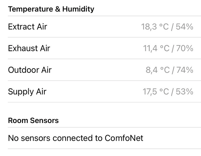

I’ve had some contact with zehnder people, the RF ones don’t show any values of the CO (got the same here), they only help to control the ComfoAir. The 0-10v versions connected to the option box can be red through the app (and maybe HA), you can see those values a little lower on the status page of the zehnder app.
If I knew that earlier, I would have bought a 0-10v set, but since everything is installed and all electricity is done, it’s not possible 8-/
