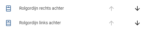

After making a switch like you described, you can also easily use that switch to create a cover entity:
cover:
  - platform: template
    covers:
      woonkamer_links_achter:
        friendly_name: "Rolgordijn links achter"
        open_cover:
          service: homeassistant.turn_off
          entity_id: switch.gordijn_woonkamer_links_achter
        close_cover:
          service: homeassistant.turn_on
That way, you can also see it as a cover in the front-end:
