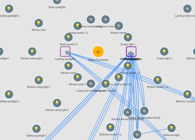

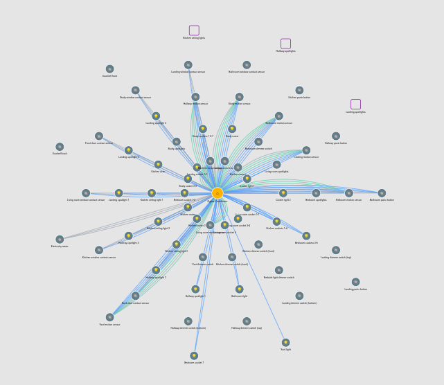

So far I haven’t been able to make the drag and drop work with individual lights (“unknown error”). With groups, on the other hand, it works immediately, so my interim solution is to create a group containing a single light.
This creates a problem on the map, which piles new groups on top of one another. So far I haven’t been able to separate them and had to use the advanced tab.

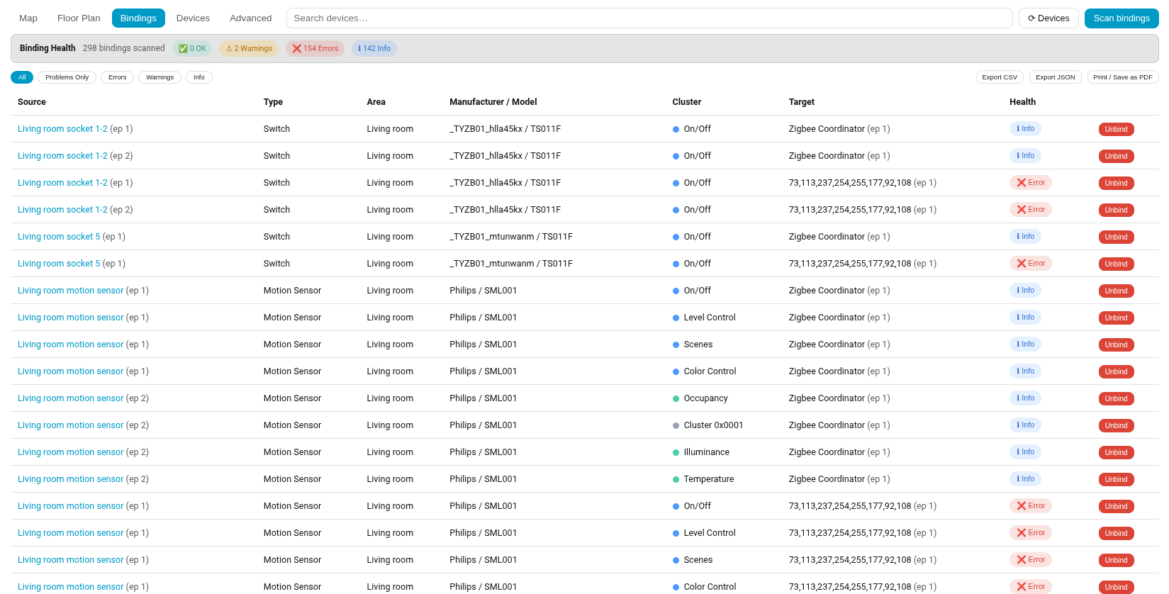

On the browsers I am now seeing no bindings at all on the Map or on the Bindings tab, although if you query particular devices in the Advanced tab the bindings are there (they are also working on the actual devices - all set up yesterday using your card). In the HA app, the bindings appear as expected.
When I click on “Scan Bindings” they still don’t appear in the browsers and I get the following in the log:

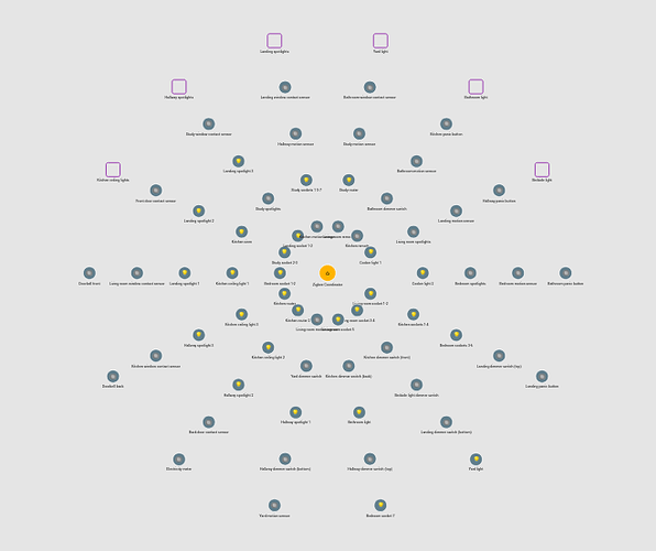

As far as the Map goes, The browsers all show groups nicely separated.
But the HA Android app shows groups piled on top of one another.

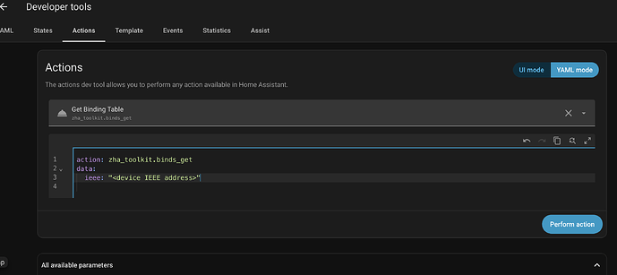

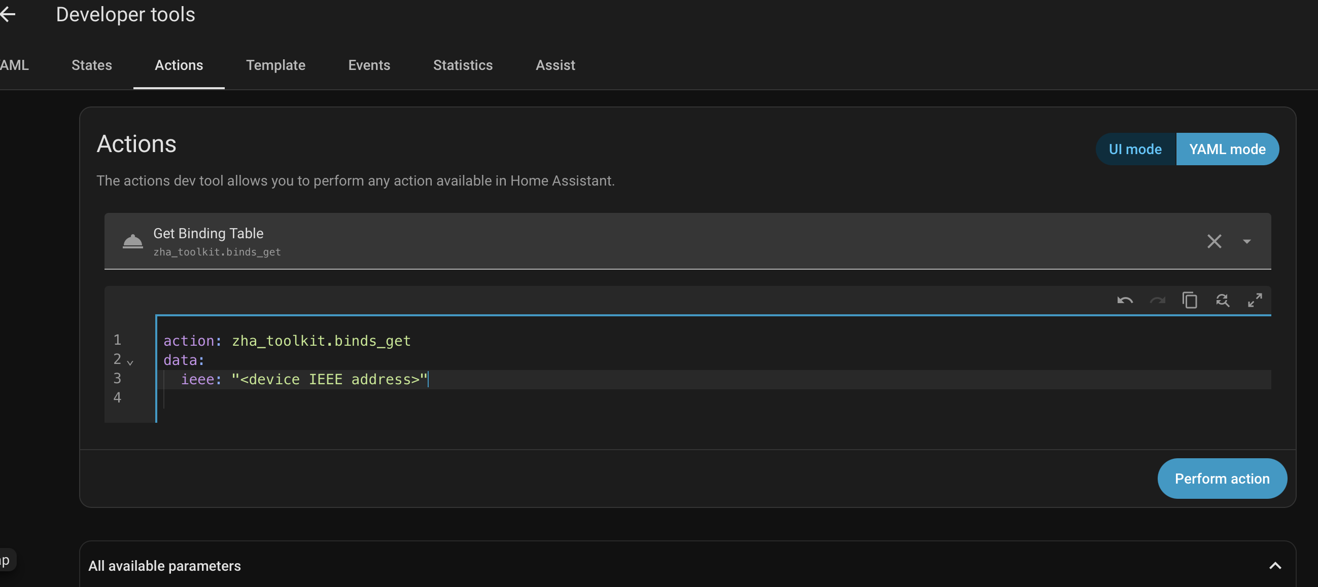

What I would appreciate you to check: please update to v0.9.1 and run “Scan bindings” again in a browser.
  1. Do bindings now show up for the devices that previously errored with TimeoutError (even if marked “partial”)?
  2. If any device still shows nothing at all, could you open the browser’s developer console (F12 → Console tab), look for a line starting with [ZHA Bindings Manager] binds_get reported failure, click to expand it, and screenshot or copy what’s inside response.replies? I’ve built the parsing for this against zha_toolkit and zigpy’s actual source code, but there’s one detail (exactly how Home Assistant converts that internal Zigbee data to JSON for the browser) I can’t verify without seeing a real example - that console output would let me confirm it or fix it fast if it’s not quite right.

OK, so to begin with, the overlaid icons on the map when using a Chromebook is a “feature” of running the HA app in ChromeOS. You can run most Play Store apps on a Chromebook, but not all of them behave as expected. The display is fine on Android devices. Probably not a priority unless you get lots of complaints (unlikely).

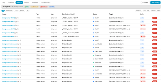

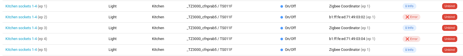

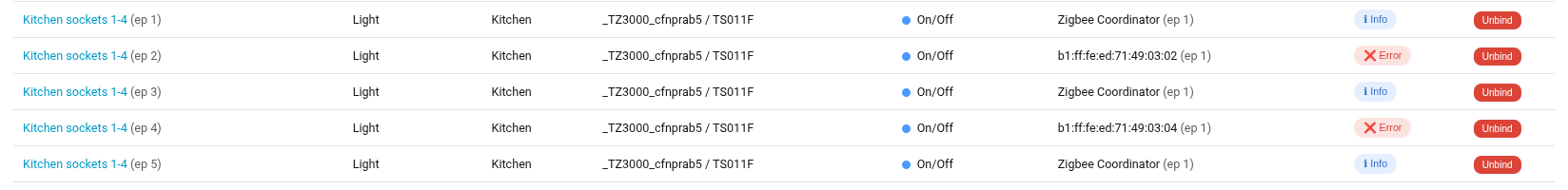

  1. Click the Scan Bindings button. The scan (64 devices) takes 12 minutes to complete.
  • The map still shows no bindings.
  • Every entry in the bindings list is marked “Error. Target device no longer exists”. No mention of “partial”.
  • In the Devices tab every device is now marked as having 0-16 bindings. These are presumably with the co-ordinator - the seven end devices on which I have set up bindings (Philips Hue dimmer switches) are shown as having none - presumably they were sleeping during the scan.

Edit: After about half an hour (while I was posting this, in fact), the co-ordinator bindings appear on the map and on the Bindings tab.
Another Edit: Just realised that the “Hide coordinator bindings” checkbox affects the bindings page as well… :roll_eyes:

Upgraded to 0.9.4.
No more toasts, but I’m still getting three devices giving false duplicates. These are all for the same type of multi-socket strip - they worked with ZHA out of the box, but there may be something odd about them.
So far I haven’t been able wake sleeping devices fast enough to get more than one picked up in the scan (there are eight of them), but I was able to scan them individually in the Advanced tab - a single click method would be great though. So I now have a complete bindings map.
I still have errors in the log:

One general point: is a dashboard card the right place for this? I now have binding maps in four browsers on two different machines, and they’re all different. The bindings are the same, but the maps are at different stages of completion. Is there a case for some sort of backend integration so that the frontend dashboard card is consistent?
Hi RedKing,
Good news first. Your “single click to rescan one device” ask is already built: v0.10.1 adds a Rescan button directly in the Devices tab for every device, so you can wake one of your eight sleepy devices and retry just that one instead of needing the full network scan to happen to catch it awake.
It also adds a configurable retry count for that button specifically (a small settings icon next to “Scan bindings”). A single retry attempt against a device that doesn’t respond takes about 45 seconds, confirmed by timing it directly. So with the default of 2 retries, you’ve got roughly 90 seconds from clicking the button to wake the device and have it respond, and so on. This only affects the individual rescan button. Your full network scan is untouched and won’t get any slower. After you’ve rescanned a device a few times, its row also starts showing its own typical response time, so you’ll get a more precise sense of how much time that specific device actually needs. I’m testing whether I could run scans across multiple devices in parallel, but this requires a bit more testing.
On the false duplicates on your multi-socket strips: this looks different from the duplicate bug we fixed in 0.9.3, and I’d rather not guess at it. Could you tell me the make and model of that strip? It’d also help a lot to see the raw data behind one of the false duplicates. If you go to Developer Tools, then Actions, switch to YAML mode, and paste this in (swapping in the IEEE address of one of the three affected devices, found on its device page):
action: zha_toolkit.binds_get
  ieee: "<device IEEE address>"
If there’s a “Response data” option, enable it before running it. Then paste whatever comes back here, the full thing if possible. That’ll show the actual source endpoint, target, and cluster values behind the false duplicate, so I can see what’s really going on rather than assume it’s the same issue as before.
On the multi-browser consistency question: fair point! The card’s intended use case is a single person managing their own network, so the frontend-only, per-browser design is a reasonable fit for that. You scan, you see your own results, no backend component to install or version alongside HA itself. Where it breaks down, as you’ve found, is exactly your setup: the same person checking the same network from multiple browsers and devices, where each one ends up with its own independent view. That’s a real limitation of the current design. I’m genuinely open to a future version that persists scan data in Home Assistant itself rather than per browser, so every view of the dashboard stays consistent. Not promising a timeline, but it’s a legitimate architectural question and on the list to think through properly rather than bolt on quickly. Feel free to log an issue on GitHub :slight_smile:
Thanks again for the thorough testing.

Upgraded to 0.15.0.
Amazon seem to sell the socket strips under several brand names, so “generic Chinese” is my best guess. The ZHA device info is:
TS011F
by _TZ3000_cfnprab5
The response to zha_toolkit.binds_get is:
zha_toolkit_version: v1.2.1
zigpy_version: 2.0.0
zigpy_rf_version: 0.49.2
ieee_org:
  - 226
  - 207
  - 239
  - 63
  - 43
  - 56
  - 193
  - 164
ieee: a4:c1:38:2b:3f:ef:cf:e2
command: binds_get
command_data: null
start_time: "2026-07-19T23:57:12.793386+00:00"
errors: []
params:
  dir: 0
  tries: 1
  expect_reply: true
  args: []
  kwargs: {}
  read_before_write: true
  read_after_write: true
replies:
  - - 0
    - 5
    - 0

Updated to 0.18.0.
Still getting errors:
And in the log:
This error originated from a custom integration.
Logger: custom_components.zha_toolkit
Source: custom_components/zha_toolkit/__init__.py:817
Integration: ZHA đź§° Toolkit (documentation, issues)
First occurred: 10:04:42 (16 occurrences)
Last logged: 10:08:25
Exception '' for service call with data '{'zha_toolkit_version': 'v1.2.1', 'zigpy_version': '2.0.0', 'zigpy_rf_version': '0.49.2', 'ieee_org': 00:17:88:01:0b:9f:a4:27, 'ieee': '00:17:88:01:0b:9f:a4:27', 'command': 'binds_get', 'command_data': None, 'start_time': '2026-07-20T10:06:56.485467+00:00', 'errors': ['TimeoutError()'], 'params': {'dir': 0, 'tries': 1, 'expect_reply': True, 'args': [], 'kwargs': {}, 'read_before_write': True, 'read_after_write': True}, 'replies': [], 'success': False}'
Exception '' for service call with data '{'zha_toolkit_version': 'v1.2.1', 'zigpy_version': '2.0.0', 'zigpy_rf_version': '0.49.2', 'ieee_org': 00:12:4b:00:29:11:b1:c5, 'ieee': '00:12:4b:00:29:11:b1:c5', 'command': 'binds_get', 'command_data': None, 'start_time': '2026-07-20T10:06:56.498994+00:00', 'errors': ['TimeoutError()'], 'params': {'dir': 0, 'tries': 1, 'expect_reply': True, 'args': [], 'kwargs': {}, 'read_before_write': True, 'read_after_write': True}, 'replies': [], 'success': False}'
Exception '' for service call with data '{'zha_toolkit_version': 'v1.2.1', 'zigpy_version': '2.0.0', 'zigpy_rf_version': '0.49.2', 'ieee_org': 00:17:88:01:08:02:80:04, 'ieee': '00:17:88:01:08:02:80:04', 'command': 'binds_get', 'command_data': None, 'start_time': '2026-07-20T10:06:56.511966+00:00', 'errors': ['TimeoutError()'], 'params': {'dir': 0, 'tries': 1, 'expect_reply': True, 'args': [], 'kwargs': {}, 'read_before_write': True, 'read_after_write': True}, 'replies': [], 'success': False}'
Exception '' for service call with data '{'zha_toolkit_version': 'v1.2.1', 'zigpy_version': '2.0.0', 'zigpy_rf_version': '0.49.2', 'ieee_org': 00:15:bc:00:39:00:2e:f2, 'ieee': '00:15:bc:00:39:00:2e:f2', 'command': 'binds_get', 'command_data': None, 'start_time': '2026-07-20T10:07:41.188965+00:00', 'errors': ['TimeoutError()'], 'params': {'dir': 0, 'tries': 1, 'expect_reply': True, 'args': [], 'kwargs': {}, 'read_before_write': True, 'read_after_write': True}, 'replies': [], 'success': False}'
Exception '' for service call with data '{'zha_toolkit_version': 'v1.2.1', 'zigpy_version': '2.0.0', 'zigpy_rf_version': '0.49.2', 'ieee_org': 00:15:bc:00:39:00:3e:15, 'ieee': '00:15:bc:00:39:00:3e:15', 'command': 'binds_get', 'command_data': None, 'start_time': '2026-07-20T10:07:41.212412+00:00', 'errors': ['TimeoutError()'], 'params': {'dir': 0, 'tries': 1, 'expect_reply': True, 'args': [], 'kwargs': {}, 'read_before_write': True, 'read_after_write': True}, 'replies': [], 'success': False}'
I notice that the ieee numbers in the errors are not the actual device ieee numbers - which is why there are no errors when I use Device Tools. Don’t know where these are coming from. If I enter one of them in Device Tools I get “No entities found for …”
Thanks for digging up the raw binds_get output.
Short version: this isn’t a bug in the bindings manager card. Running the raw byte arrays you posted through the same decode logic the card uses lines up exactly with zha_toolkit’s own result output - including the two bindings on endpoints 2 and 4 that resolve to an address that isn’t a real device. That corruption is already present in what zha_toolkit hands back, before the card ever touches it, so there’s nothing on my end to fix here that will resolve it.
The pattern itself: endpoints 1, 3, and 5 all decode correctly to the same real target device, which is expected for a 5-gang strip like this. Endpoints 2 and 4 - always the second binding entry returned in a given response page - decode to a garbled address. The corruption is very consistent, which points to either the device’s own firmware sending a malformed second record, or a parsing quirk further upstream in zigpy. Either way, it’s a zigpy/zha-toolkit (or possibly TS011F firmware) question rather than something addressable in the card.
If you want to chase it further, a couple of things would help narrow it down: running binds_get a couple more times to see if the corrupted bytes (IEEE numbers) are identical each time (points to something deterministic vs. transient), and if you’re comfortable with it, turning on debug logging for zigpy to see whether the bad bytes are already there before any parsing happens. That’d be useful evidence if you end up filing something with the zigpy or zha-toolkit projects directly - they’re better placed to take it from there than I am.
Appreciate you taking the time to pull the raw data.
I think I’ll be able to live with it - just a couple of errors when I do a scan. Thanks for looking into it.
The card’s looking better and better - a really useful tool.
