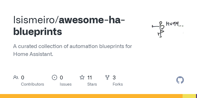

Can you confirm that you are using the latest blueprint from lsismeiro 's repository?
Just want to make sure, this seems like something that’s now been fixed.
I have checked this myself using the latest from there and am not experiencing the same issue as yourself.

Hoooo shiittt. This indeed did the trick. Damn! Good job. I was using the old EPMATTs one.
