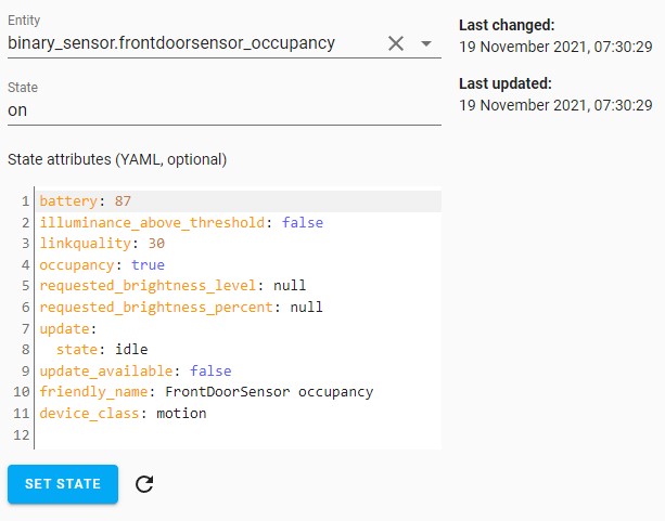

Interestingly between ZHA and Zigbee2MQTT I found the ‘triggers’ change… for example, my Ikea motion sensor under ZHA the motion sensor was either ‘on’ or ‘off’ which is what I had as the trigger in my automations.
Unfortunately trying to find the ‘triggers’ used in Zigbee2MQTT is proving to be a challenge. I found this under the ‘State’ tab in the Zigbee2MQTT WebUI…
"battery": 87,
"illuminance_above_threshold": false,
"linkquality": 15,
"occupancy": false,
"update": {
"state": "idle"
"update_available": false
And so I entered the trigger in my automation as either ‘true’ or ‘false’ but the automation never triggers? Then under developer tools I looked at the state of the motion sensor, and it was advising the state of the motion sensor was ‘off’ which was a bit confusing.
Here’s a screen capture…
So, looks like I will be setting my automation to ‘on’ and ‘off’ instead of ‘true’ or ‘false’ but I am not sure if that is going to work?
Edit: As I suspected, ‘on’ and ‘off’ didn’t work… hmmm… and ‘true’ or ‘false’ doesn’t work?
This should work:
trigger:
- entity_id: binary_sensor.frontdoorsensor_occupancy
platform: state
to: 'on'
