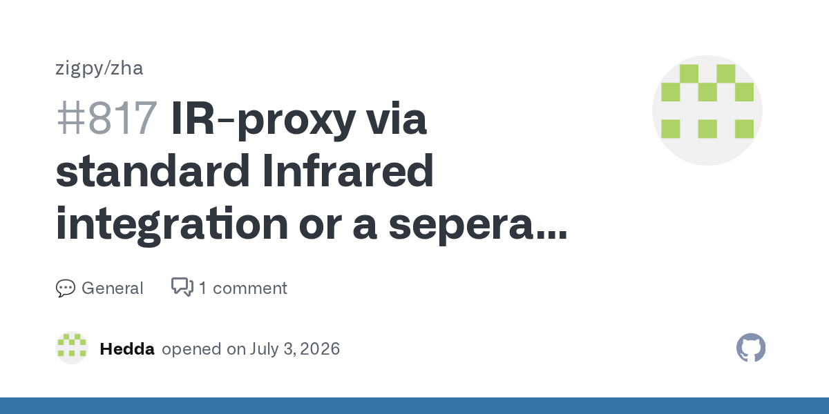

IIRC I believe read somewhere else too that another ZHA developer mentioned they wanted to build something that uses the new standard infrared integration so could instead use Zigbee IR blasters as a IR-proxy. Opened a seperate discussion for that in the zha repo here -> IR-proxy via standard Infrared integration or a seperate Infrared Blaster integration built on-top of ZHA? · zigpy/zha · Discussion #817 · GitHub
Was there not and idea raised to make an "IR-proxy" interface for Zigbee IR blasters via ZHA that builds on-top of the infrared integration instead?
That is, a wrapper that makes it work similar to an ESPHome-based proxy:
As described in this blog post:
