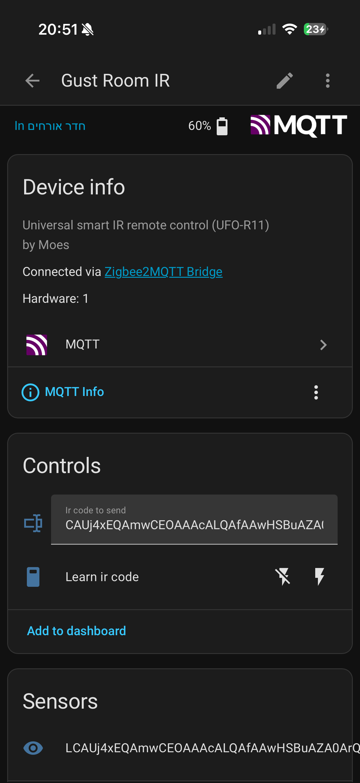

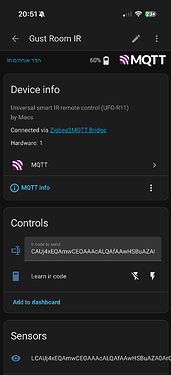

For example, here is my UFO-R11:

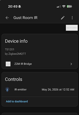

After installing the integration you will see a new IR entity:

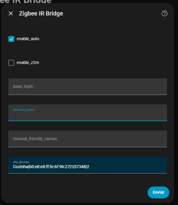

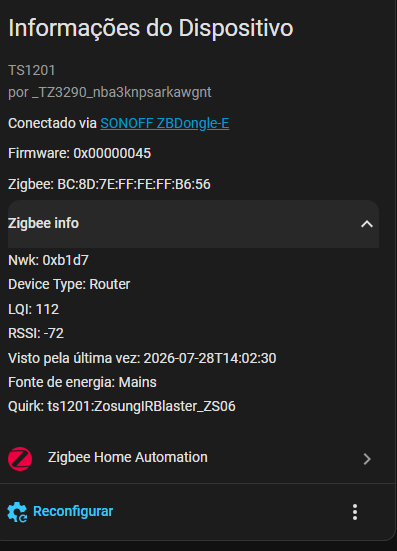

Hi @Tomer11, thank you for creating this integration!
I’ve been trying to use the “Zigbee IR Bridge” with my Tuya TS1201 IR blaster connected via ZHA, but unfortunately, I haven’t been able to get it to work properly with my setup (controlling a Gree AC unit).
One thing I noticed while troubleshooting: I tried to create a custom quirk for the TS1201, but my Home Assistant (running Core 2026.7.4) kept ignoring it and always captured the native quirk (Quirk: ts1201:ZosungIRBlaster_ZS06). I’m not sure if this is one of the main reasons why it’s failing to work with ZHA.
Since you mentioned that ZHA support was harder for you to test compared to Zigbee2MQTT, could you share any specific tips, cluster commands, or requirements for getting the TS1201 working correctly under ZHA using your integration?
Any insights or troubleshooting steps for ZHA users would be greatly appreciated!
Here some data from my end:

Your quirks path is incorrect. It needs to be:
zha:
  custom_quirks_path: /config/custom_zha_quirks/
  enable_quirks: true
and you need to create a folder named exactly custom_zha_quirks in HA’s config folder (the same place where your configuration.yaml file is stored). Then, put the quirk file in that folder & restart ZHA.
Thanks a lot! now I have the custom quirk here, but I still have issues to send the command to my air conditioner.
for example, Im using this one here
action: z2m_ir_bridge.send_code
  backend: zha
  zha_ieee: b0:e8:e8:ff:fe:6f:96:27
  zha_endpoint_id: 1
  zha_cluster_id: 57348
  zha_command: 2
  code: "CAUj4xEQAmwCEOAAAcALQAfAAwHSBuAZA0ArQCdAB8ADQA9AAUAPQAvAB0ALC9IGEAJsAhAC0gYQAg=="
the code using here I learned using my AC controller.
I configured my IR folowwing the contract from ZHA
Cozinha|b0:e8:e8:ff:fe:6f:96:27|1|57348|2
But still have the IR emitter as unknown but no errors here in my logs (no picture because Im a new user and I can post only one picture by post, sorry)
