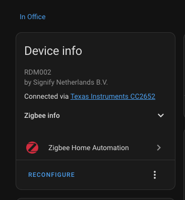

I’m surprised to hear this. You definitely have a Philips RDM002 as pictured in the first post and its connected via Zigbee Home Automation (and not Zigbee 2 MQTT or something else)?
Can you share a picture of what you see when you look at the device? I see this for mine.
My devices are connected via Zigbee 2 MQTT !
This blueprint, and the other one I referenced, is specific to Zigbee Home Automation (ZHA) and doesn’t support Zigbee 2 MQTT.
Unless you decide to switch to ZHA, I’m afraid you won’t be able to use it. I’m glad we at least figured out what the issue was!
