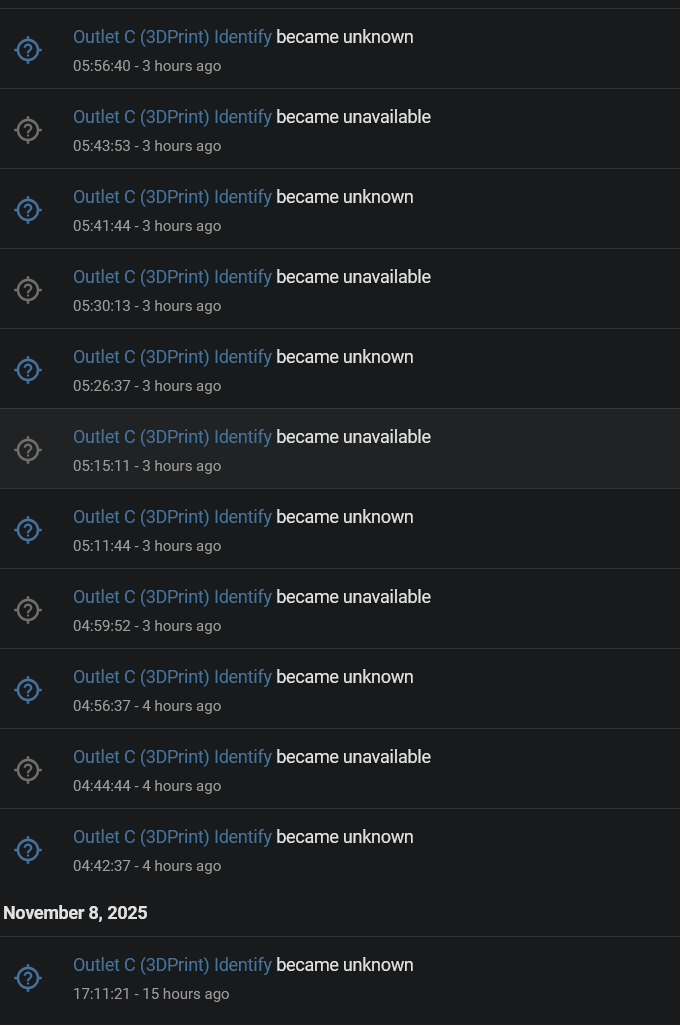

I would appreciate some pointers to debug further. Since a few weeks, my Zigbee installation is almost unusable, without a conscious change on the user side.
Initially, I observed that there was some issue when HA was restarting - the integration was not able to finish loading; from the message it pointed to the serial device being in use. But that fixes itself after a while - and I have not seen it lately. Hm.
But the real troubles began a bit later, when the lights and switches all just stopped responding, despite still being “available” in the graph. I trigger a light change from HA, then just get errors like NWK_NO_ROUTE 205.
As a remedy, I powered off ALL mains devices in the network, restarted HA, and turned them on one by one: Result: A stable network - for a while. After a reboot of the HA PC (updates), the network was again in a broken state. Interestingly, even in this state, battery powered devices close to the coordinator still publish their info (like motion detectors, buttons etc).
From this, I deduce that there may be some sort of routing problem, which I have trouble figuring out further. Is there some state somewhere I can force to reset, to rebuild cleanly (similar to the staged repowering I did, but from a coordinator/routing perspective)?
Should I look into HW/radio issues (unlikely as there was no change there)?
Could it be a Zigbee device, trough which most messages would be routed, suddenly became insane and blocks the network?
What can be checked from software level?
Shoud I try to use source routing?
Is there a known issue as of late?

What gets me is that it was rock-solid after repowering all routers step by step - and then suddenly went into failure mode with the HA PC reboot (but of course it also did otherwise, some time in the night a few days before…).
The PC was booted at 4:41, and this zigbee outlet is ~4m from the coordinator.
Could be coincidence with something in the neighbourhood or a node going crazy, but not the first guess I would say.
What could lead to such a failure, and how could we get more info (debug logs maybe)?

Powering the outlet off and on again makes it work instantly.
These outlets form the backbone of my routers. Could it be that one or more of them are going bad (I had the case that one was toggling its relay on and off, that killed the network completely until I got rid of it. Not the case now though), or there was some background FW update pushed to them that broke thing? Any way to find out?
