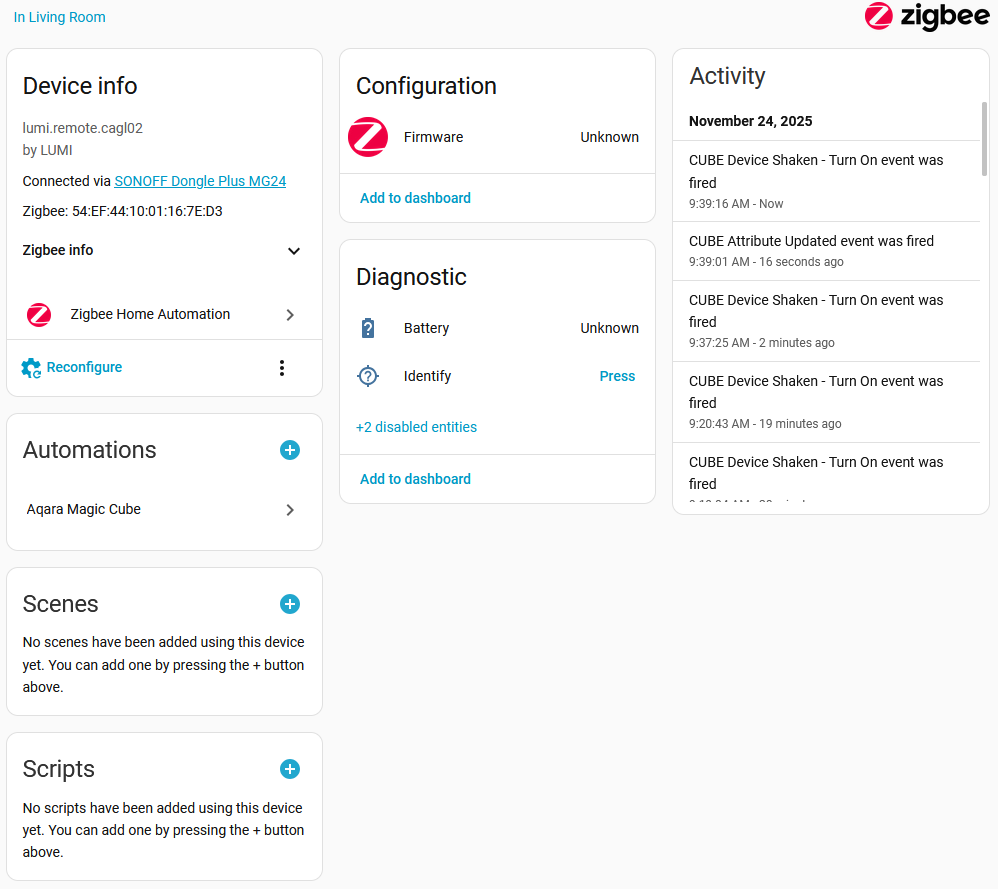

I am having trouble getting more than one function. “Shaken” works and nothing else I have done triggers an event, other than what appears to be a mode change after pressing the button five times.
I have removed and re-added the cube a couple of times. I have rotated it every way on a flat surface and tapped it once, twice, or three times gently and not so gently. I have tried it at my desk, where the interview and other devices work well, but also within 8 feet of the antenna. No activity appears. When I shake the cube, that is registered immediately and consistently.
An automation based on shaking works fine. I tried a few others and nothing happens.
One thing I picked up here was to be sure the interview completes correctly. The last time I waited much longer than before and it went from saying the interview was complete (I always waited for this) to saying the device was ready to use. No change in behavior.
Any ideas?
In the screen shot the “Attribute Updated” event appeared after pushing the button five times.
