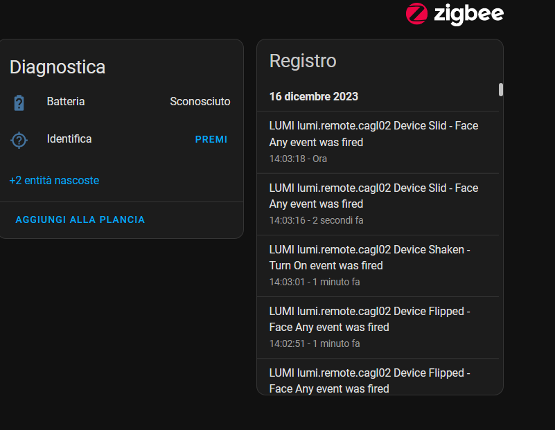

Hi!
I have the Cube T1 Pro (connceted with ZHA and skyconncet).
My aqara can shake and rotate, filp, slide but can’t knock.
I should be in the right mode (if i change mode i can only rotate and shake).
Sometimes if you don.t delay long enough between moves, the move won’t register. make sure there is a 1 or 2 second pause right before the knock.
Plus you have to be doing the knock right. There’s a video above of how to do it.
Finally id you add the event sensor and put the sensor entity on your dashboard, you will see what the blueprint thinks your move was. That will help with training.
Foe ZHA figuring out the mode is a pain. Yoyu probably have to look at the zha events or in the lohistory for the device to see if scene or action mode.
thanks for your advices.
I’ve try to wait but i can’t still knock.
I’ve also try to update the firmware of skyconnect but nothing changed.
Is it normal that i see all the move in the regiter as ā€œface anyā€. It can’t detect (for example) slice face 1, slice face 2, ecc.
I could try buing another dice but i think is my configuration the problem
If you would like to read my instructions again, I’m sure this is the problem…
https://github.com/SirGoodenough/HA_Blueprints/blob/241faf3e5f7438eeeb9af0e9c1cc0eda53180f08/Automations/ZHA-Xiaomi_Cube_Controller.md#--hardware-versions.
Put it into action mode, it is the only mode that works properly on ZHA and the people that set-up the zigpy device registry have not made a proper interview device for this cube. Complaints would need to be registered there…
(It all works fine in Z2M, BTW)
The T1 pro Cube is missing new functions that are available in the device. Ā· Issue #2145 Ā· zigpy/zha-device-handlers Ā· GitHub. to thumb up this to possibly get this fixed…
Thank you again. I thought that listening the event from ZHA was fine.
In the dev tool i see the face of the dice and i was able to see a knock too
But only one (i wasn’t able to repruduce it).
I haven’t find the video that show how to knock the dice (i’ll try again).
Thanks again
