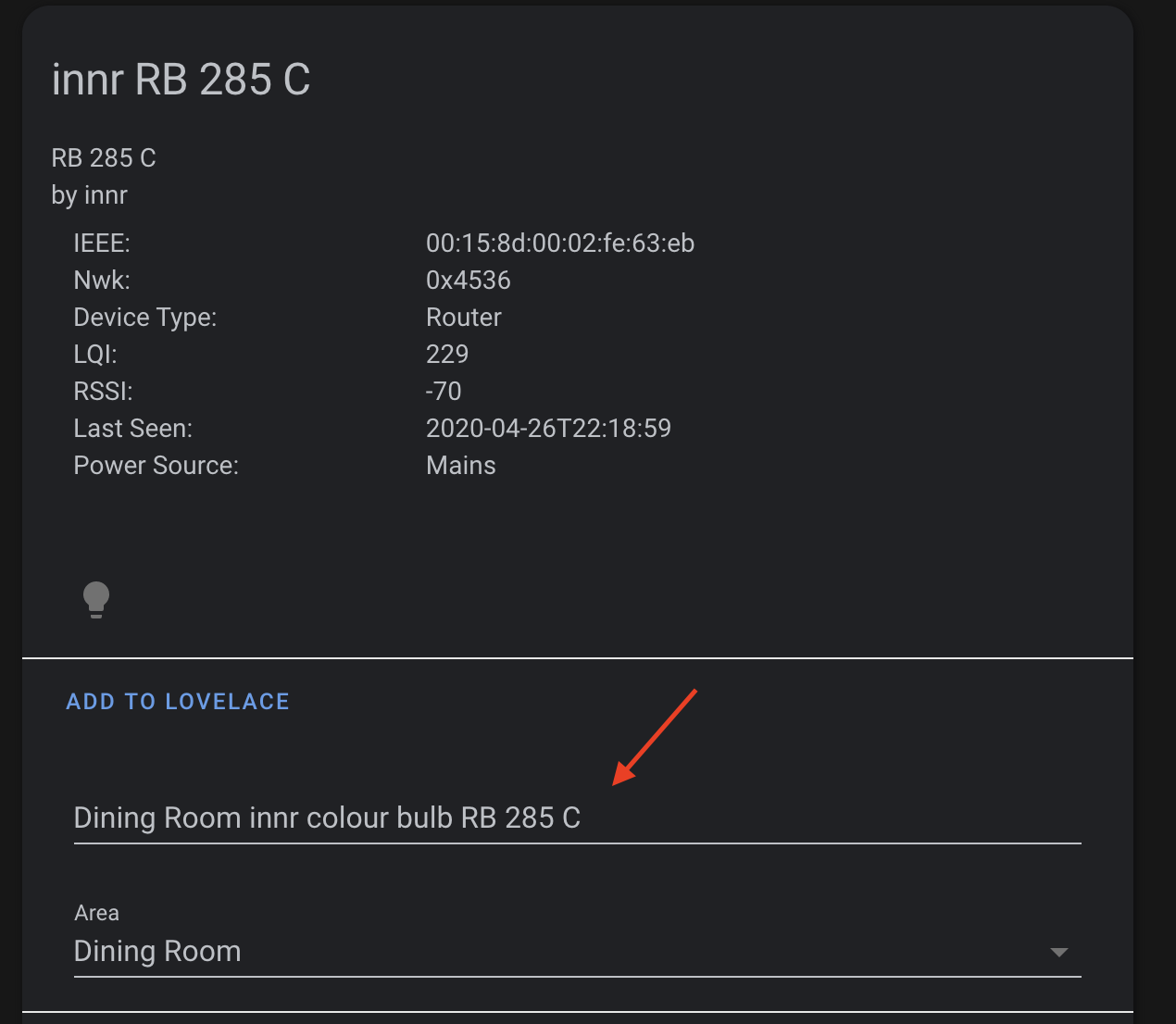

So I was going to use the web interface to create a zigbee group for my lights. I have over 26+ sengled E11-G13 lights. When more then just the ones I want to add are turned on it is hard to see which light it was. They say a picture helps. Is there anyway to get this to show the friendly name or customized name?
I think you need to customize the name in the Dev panel for the Device Zigbee device, the actual light entity is a child of:

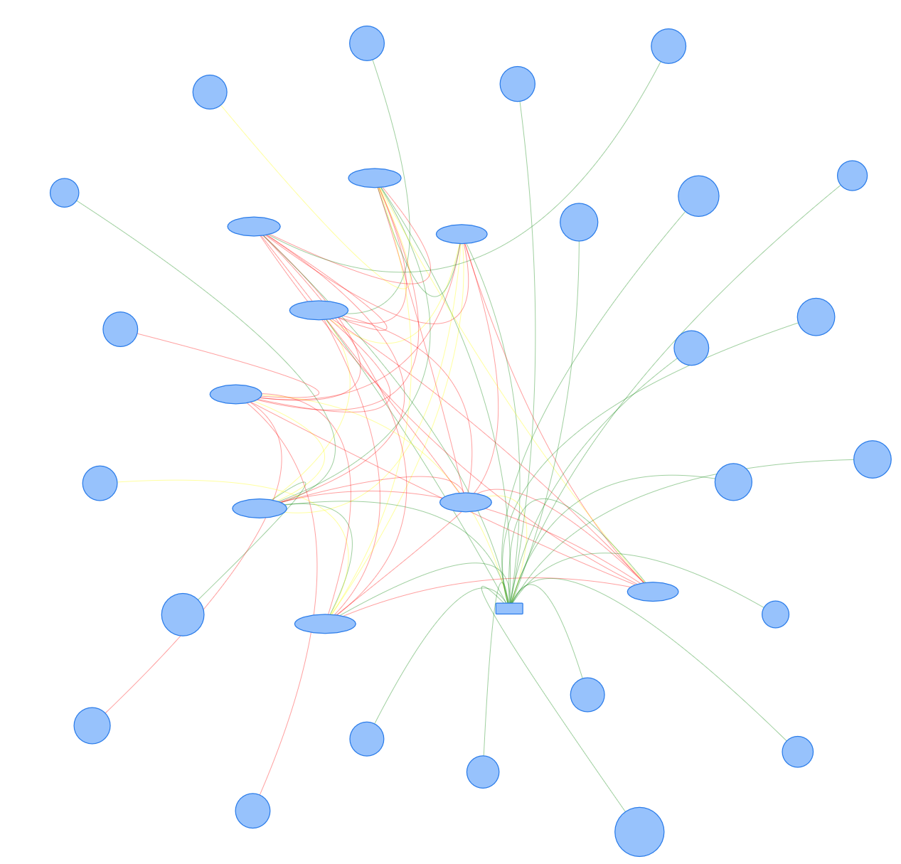

Have you got any suggestion, with HA in mind?
My map (without the 2 thermometers):
With ZHA the ezsp based radios are the most widely tested.
Xiaomi are always fun to pair, may need a few attempts and keep device awake while pairing. Unless it is a very new Zigbee 3.0 xiaomi, just try again and try moving xiaomi closer to another router or coordinator. I don’t think there were many reports about xiaomi temp sensor pairing
