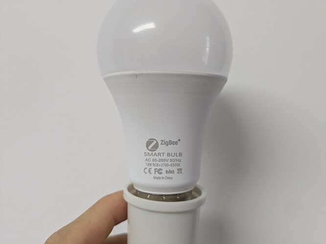

Any ideas what can I try to get a Zigbee LED Light working there?
See picture attached for the LED Light bulb:

Have you tried setting the bulb up elsewhere, then moving it into the safe room? I believe the initial connection with the coordinator needs a better signal than day-to-day usage.
I’ve already set the bulb up in my room and it works just fine but when I take it out of the bulb screw thing it loses power and when I connect it back up to the bulb screw in the room it doesn’t do anything except light up regularly, none of the commands work.
