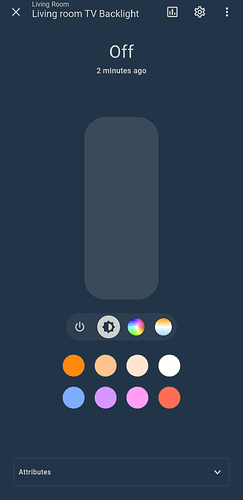

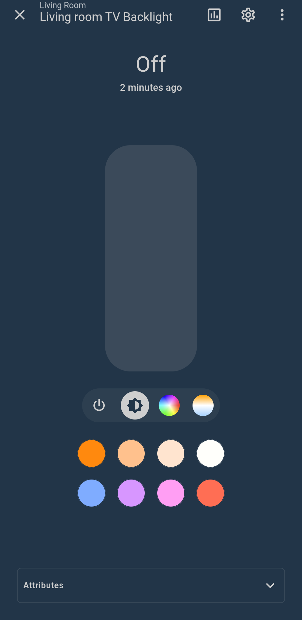

I’m turning it on from the entity page, by pressing the power button seen in the attached screenshot. The behavior occurs whether the light is turned on from the device entry, from a card, or via an automation.
In this case though, there’s no YAML to share since the “light turn on” action isn’t occuring via any custom YAML. I’m just toggling it on in the device page.

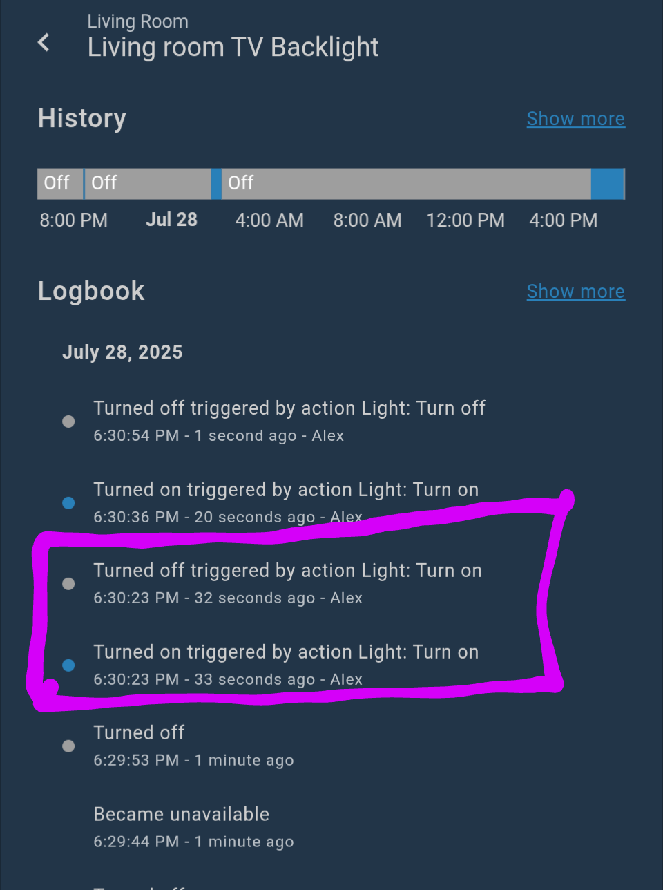

Not sure I understand what you mean. OP posted the relevant log entries in the first post:
No idea why there are two turn on actions, but there are still no turn off action and no toggle action.
There is however a turned off state change, which do not come from HA and I see now that the became unavailable state change is at the same time too. That last part was hidden by the picture bar for picture elements.
This still suggest an external action outside the HA ecosystem or a faulty device.
