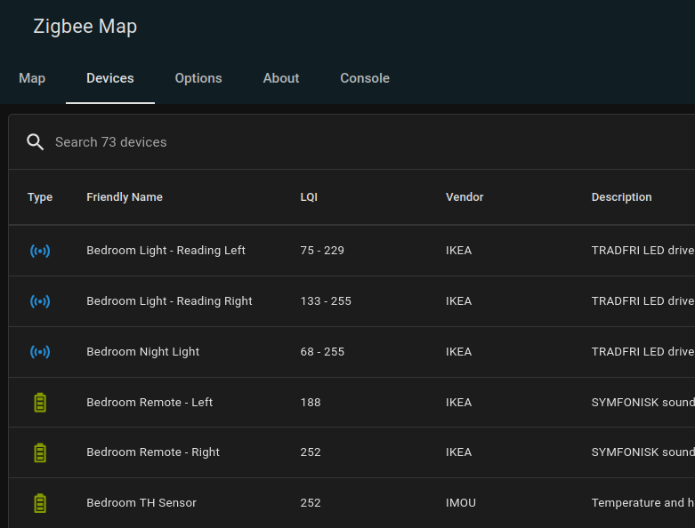

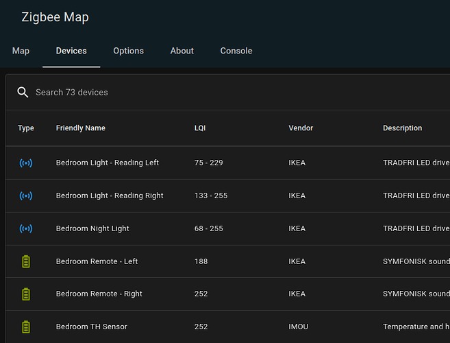

  1. It would help me a lot, if there was an additional column in the ‘Devices’ tab (maybe only for EndDevices) that shows the signal quality (LQI) for that device.

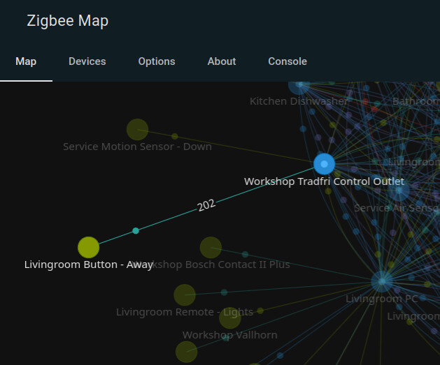

  3. When I drag (or double-click) an EndDevice show the LQI value for that device’s connection?

#4 comes from a good place, but I believe it does more bad than good, simply because that’s not how zigbee routing works: consecutive messages between the same source and destination might take different paths; also request and reply messages between 2 devices most likely use different paths too. Zigbee routing is an unpredictable mess that somehow just works.
Mess, and/or mesh? Often both!
Released version 1.2.0 with the following changes:
Added
Have fun!
