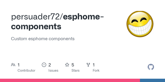

However, it looks like the ESPHome implementation is not upstream. Also, I want to have the logic in the Shelly so that it works even if the wifi is broken for whatever reason (or at least an option to prevent heating stuck).

You can do all that with stock Shelly firmware. Thry can operate autonomously, over the cloud, inside LAN, or all of that simultaneously. The esphome custom component doesn’t currently work with current esphome. I’m hoping for it to be fixed so I can test it.

I would like to flash esphome onto the 1PM, but the temperature addon doesn’t work on it right now, so I can’t. That would allow me to configure a PID controller right on the device itself, making it independent of home-assistant. The shelly software let’s you configure a simple hysteresis thermostat, but I want a PID.
