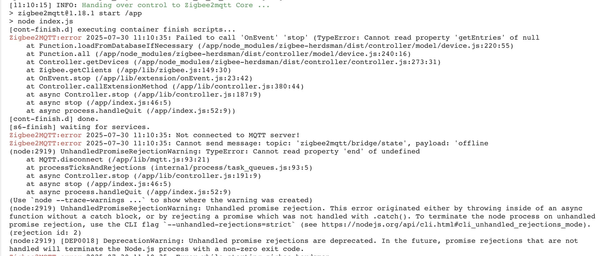

it has been a while that I am trying with zigbee2mqtt
the log is below :
[10:51:25] INFO: Handing over control to Zigbee2mqtt Core …
[email protected] start /app
node index.js
Zigbee2MQTT:error 2025-07-30 10:51:45: Error while starting zigbee-herdsman
Zigbee2MQTT:error 2025-07-30 10:51:45: Failed to start zigbee
Zigbee2MQTT:error 2025-07-30 10:51:45: Exiting…
Zigbee2MQTT:error 2025-07-30 10:51:45: Error: Failed to connect to the adapter (Error: SRSP - SYS - ping after 6000ms)
at ZStackAdapter. (/app/node_modules/zigbee-herdsman/dist/adapter/z-stack/adapter/zStackAdapter.js:94:31)
at Generator.throw ()
at rejected (/app/node_modules/zigbee-herdsman/dist/adapter/z-stack/adapter/zStackAdapter.js:25:65)
npm ERR! code ELIFECYCLE
npm ERR! errno 1
npm ERR! [email protected] start: node index.js
npm ERR! Exit status 1
npm ERR!
npm ERR! Failed at the [email protected] start script.
npm ERR! This is probably not a problem with npm. There is likely additional logging output above.
npm ERR! A complete log of this run can be found in:
npm ERR! /root/.npm/_logs/2025-07-30T09_51_45_392Z-debug.log

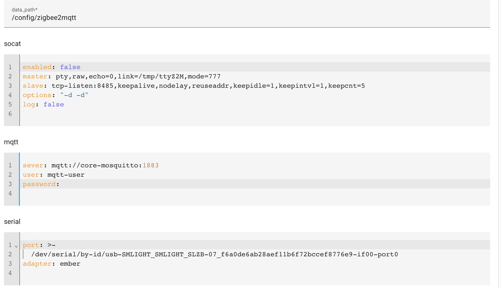

sorry I am just new to home assistant , ok let start with my my Configuration :
My coordinator is :
SLZB-07 Zigbee USB coordinator.

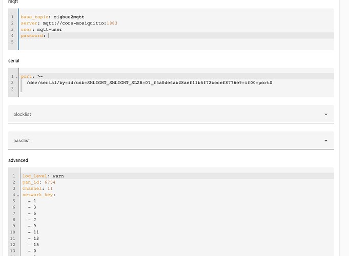

My configuration is :

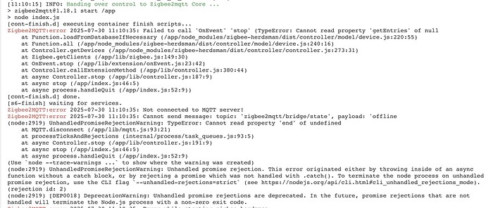

My log :
Where did you get this one ? Already a few years old. Current version is 2.5.0, not 1.18.1
And SLZB-07 has a silabs chipset, so you need to specify ember

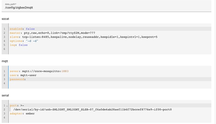

I followed your kind instruction :
My new config

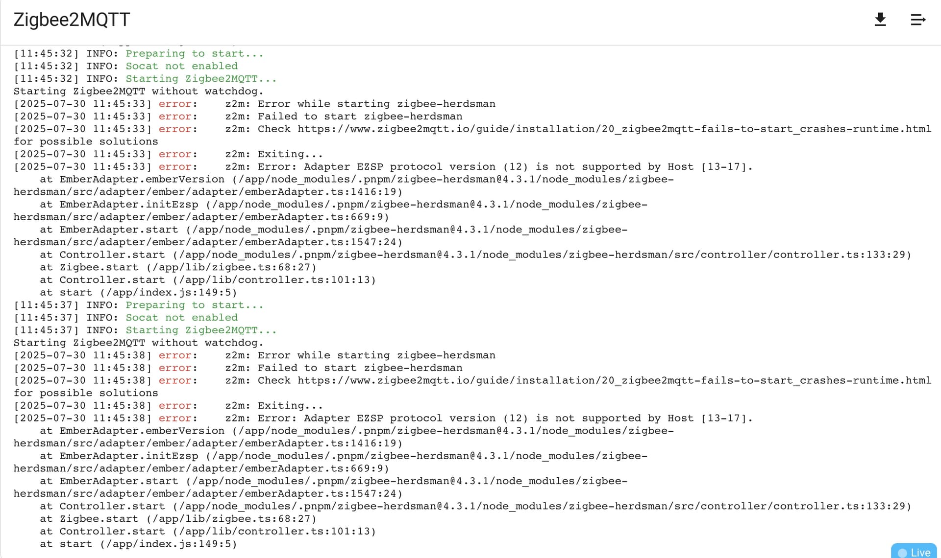

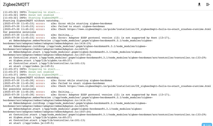

New log of Zigbee2mqtt
it is updated
Difficult to answer if you post logs as a picture.
afbeelding
2 solutions:
  • change ember to ezsp
  • update your adapter to firmware 7.4.x or later (preferable 8.0.2 or later)
Second option is the best.

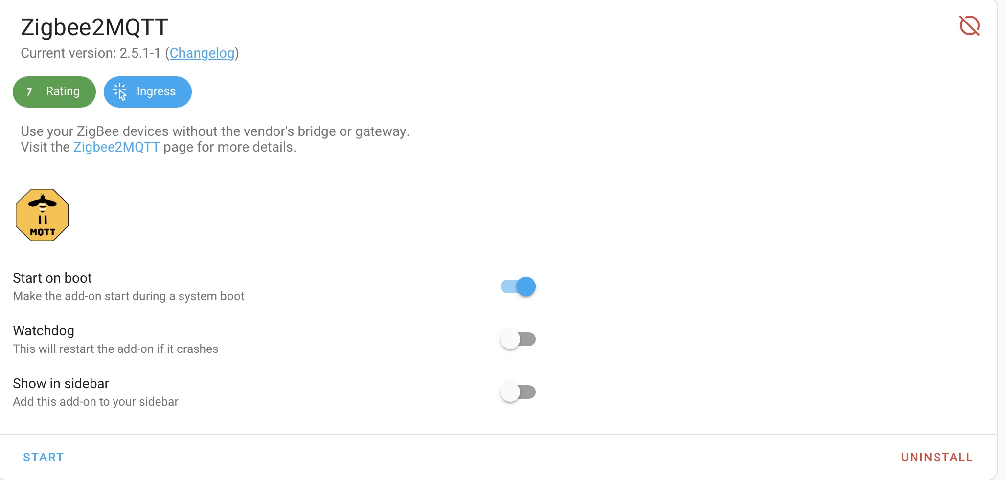

I am sure it is not running it is pop up after update

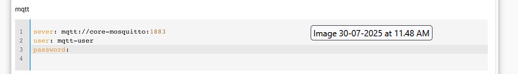

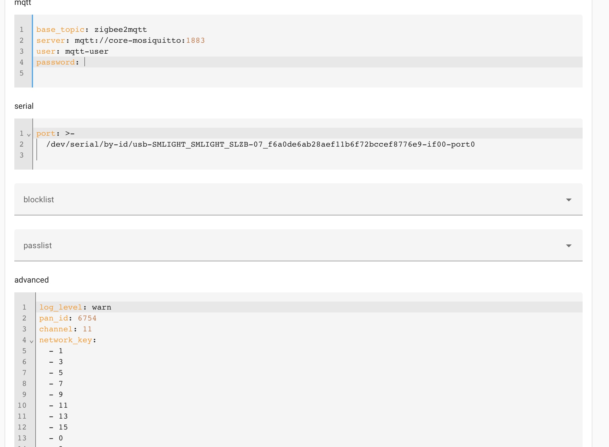

No password , so fill this in
it is filled I removed for the picture

if you are running the add-on, try with
server: mqtt://core-mosquitto
(without :1883)
same issue and same Log
server: mqtt://xx.xx.xx.xx:8123
where xx.xx.xx.xx is the ip address of your HA ?
