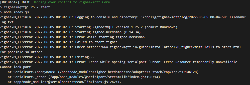

I having the following error in the zigbee2mqtt repeatedly:
Zigbee2MQTT:info  2020-09-07 15:43:34: Logging to console and directory: '/share/zigbee2mqtt/log/2020-09-07.15-43-33' filename: log.txt
Zigbee2MQTT:info  2020-09-07 15:43:46: Starting Zigbee2MQTT version 1.14.4 (commit #unknown)
Zigbee2MQTT:info  2020-09-07 15:43:46: Starting zigbee-herdsman...
Zigbee2MQTT:error 2020-09-07 15:43:49: Error while starting zigbee-herdsman
Zigbee2MQTT:error 2020-09-07 15:43:49: Failed to start zigbee
Zigbee2MQTT:error 2020-09-07 15:43:49: Exiting...
Zigbee2MQTT:error 2020-09-07 15:43:49: Error: Error while opening serialport 'Error: Error Resource temporarily unavailable Cannot lock port'

I get this sometimes when I reboot, never worked out why, but to fix it (presuming your problem is the same as mine) stop the addon, unplug the USB, count to 10, plug it back in, restart the addon.
If that doesn’t work I’m out of suggestions, but always works for me here.

Change in your Zigbee2MQTT configuration the way you adress your Zigbee USB Stick from ā€œ/dev/ttyxxxxā€ to " /dev/serial/ by-id /xxxx" if it’s not already done. :wink:
Yes, ive always set it up that way, same with my zwave stick, that way I can plug them in either port.
Im having same issue as OP. Always get the ā€˜cannot lock port’ error.
I bought a Sonoff adapter since its recommended to be used with Zigbee2MQTT and still same thing. Im unplugged all other sticks just to rule them out as a conflict…
What is tour setup? A Rpi4 with HAOS or?
The sonoff, have you firmware upgraded it?
Have you checked that nothing else is using the dongle, like ZHA being installed as it detects the sonoff?
Do you use a USB cable extender?
It means another process is already using the dongle (perhaps ZHA?):
Using home assistant blue.
Did not do any upgrades to Sonoff. Straight outta the box.
I dont know how to check if anything else is using it. I do/did have ZHA installed that I currently use with my Nortek stick. But I went into my Integrations and i disabled ZHA, then restarted host.
Yes, I use a 4" USB cable extender.
Have a look in this thread for firmware upgrade of the dongle, as a try. Im not sure this is the problem as it indicates ZHA is using the port, however with ZHA disabled this should not happen
Well its working now, but i changed two things so unsure if it was one or both.
  1. I upgraded as you suggested.
  2. I enabled ZHA but then plugged in my Nortek stick first. THinking that if ZHA was busy with Nortek, he wouldnt have time to lock the sonoff.
