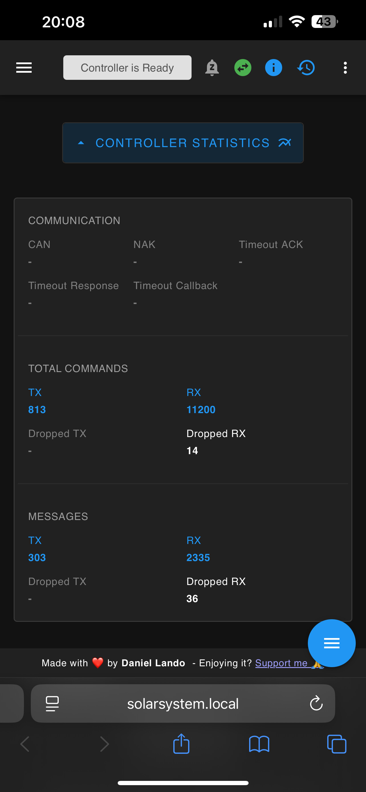

The controller has 14 dropped RX messages and 36 dropped RX total commands. No dropped TX commands or messages. Only two nodes have 5 or less dropped RX commands. This is all after 2 hours up time. The nodes have considerably less dropped RX commands than with the Aeotec controller. They would have close to 50 by this time.

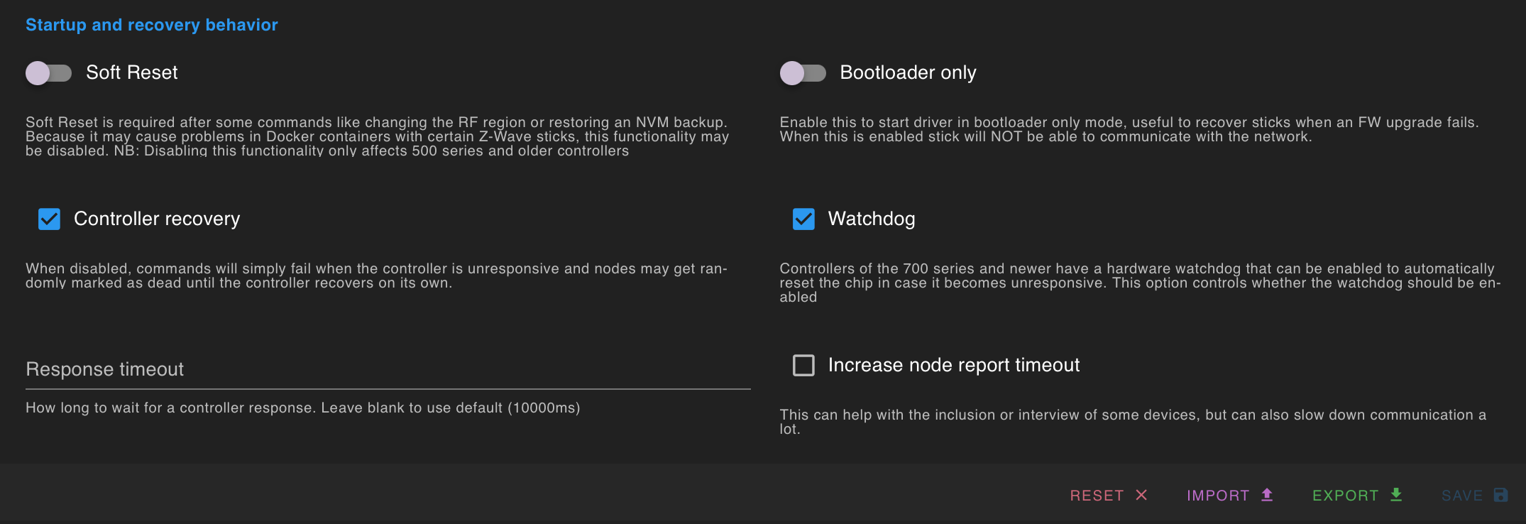

I would still suggest you try the usual troubleshooting stuff when diagnosing radio issues. Although the zwave controllers can be susceptible to jams, I dont think it should be that bad, especially on the newer sdk revisions. Make sure your usb connection is not usb 3, the antenna placement is ideal, the device is on the latest firmware, etc. Try and see if there is also a soft recovery function in your setup.

There is a soft reset option. It’s always been disabled for me. However, if I read the note correctly it seems disabling doesn’t apply to newer controllers like the ZWA-2. It doesn’t imply these controllers just automatically soft reset, but it seems to do so anyway. Anyway, turning it on doesn’t seem to do anything different in terms of issues I experience.

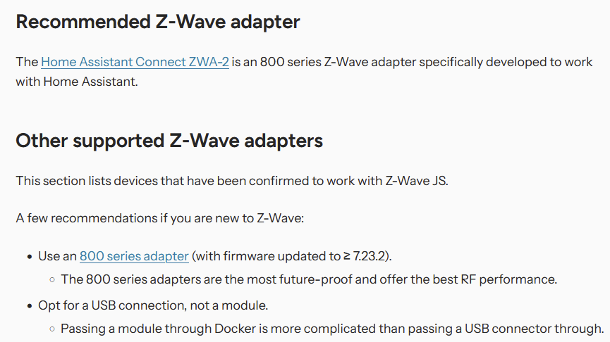

The thing that I do not understand: Nabu Casa suggests to get controllers with v7.23.2 minimum and yet, the ZWA-2 is in v7.23.1 :frowning:

The issue is just as present in the 7.23.2 and higher SDK’s as it is in 7.23.1, so don’t expect updating the ZWA-2 to 7.23.2 to fix the issue.

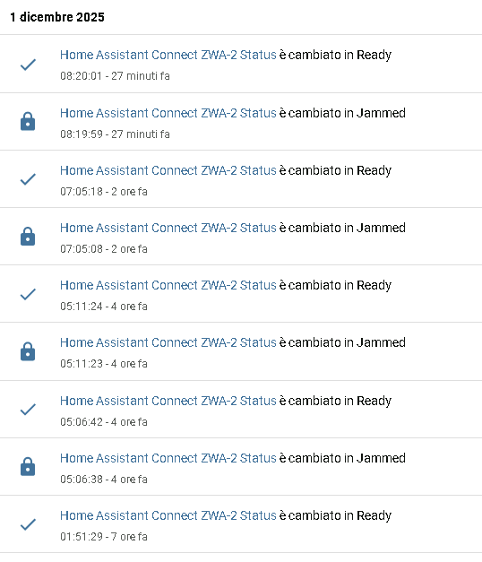

My ZWA-2 is costantly jammed ( Controller is unable to transmit)
Zwavejsui soft resets are able to mitigate the issue, but yesterday I had to unplug the controller to have my network back. And I lost a difficult to physically reach node.
