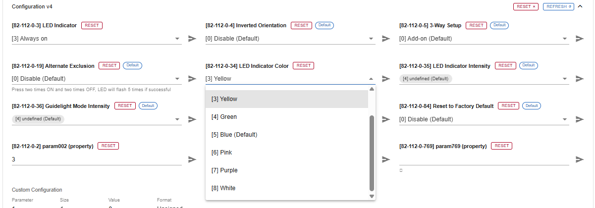

Hi, from the Z-Wave JS Control Panel, select your z-wave device and click the down arrow to expand the options for the device (1 in the screenshot).
Then select the Configuration options for the device by expanding that tab open (2 in the screenshot).
From there, find the parameter you want to change. Then change the value by direct entry or list of options, then select the upload button to the right of the parameter (3 in the screenshot).

This is the UI you get for manually setting config parameters:
It’s exactly the same thing as the zwave_js.invoke_cc_api service code I posted above, just in a more convenient UI form. There is zero difference in functionality.
